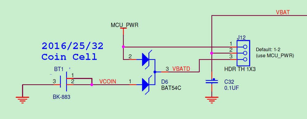

No responses yet, so I'll share what I've got so far.  I found the Kinetis Peripheral Module Quick Reference (KQRUG) - a document I've never come across before and that I can't seem to find through browsing the documentation library - and it includes a little information.  It shows a dual Schottky diode being used to provide alternate power from VDD, and on page 50 it says:
If VBAT supply is not present, then accesses to the RTC registers may not occur and could result in a core-lockup type reset in the MCU.

Hui_Ma
Hi Scott,
Sorry for the later reply.
The Kinetis product doesn't have VBAT voltage detection feature.
As you mentioned before, customer could use below design to make sure there with power supply to VBAT pin:
Or, there need to use an ADC pin to detect the VBAT voltage with setting time interval.
