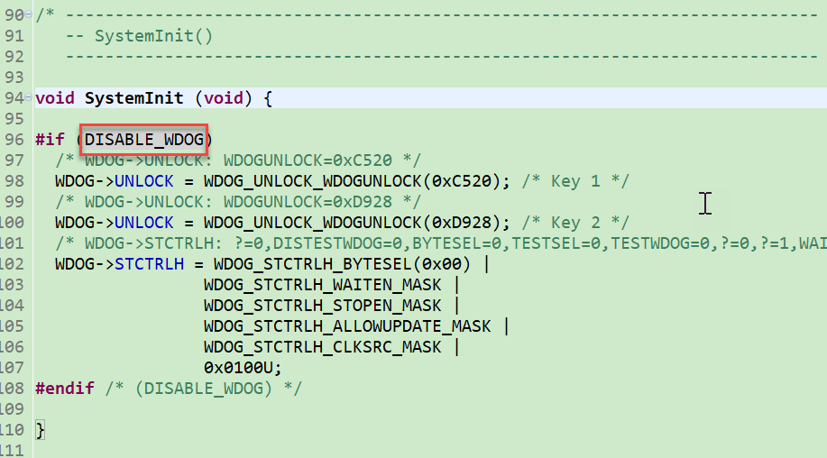

I have a design of customized board for control board based on KV10Z32VL7 .the signal on the reset pin is shown at the graph below.
the watchdog timer is disabled.

amerzater
resetISR routine is showen at the image below.which clears that WDG is disabled right after the reset.ISR.png
2,682 Views
Hui_Ma
The code below SystemInit() is gray, which doesn't included during compile.
The SystemInit() function provided disable Watchdog function with default DISABLE_WDOG definition.
From you description,  could you check if you can debug into main() function?
If not, which code will cause the chip reset?
Mike
2,682 Views
amerzater
Many Thanks, Mr. Mark
actually, I have DISABLE_WDOG defined as 1 already..
but running any example code is causing the chip to reset it self..
I have tried two different chips on two different board of the same customized design and I got the same result.
