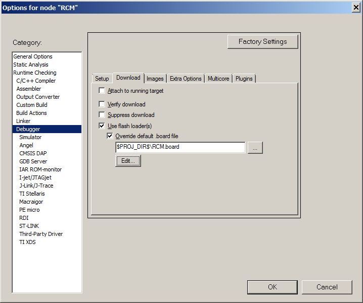

MKM34Z256 bare-metal drivers and examples disables /NMI interrupt by default in order to eliminate this non-maskable interrupt to occur. However, this is not happening in your project because your project is configured not to program flash configuration field (0x40c-0x40f) where /NMI interrupt should be disabled by writing FTFL_FOPT[2]=0.
In order to correct your existing project, you need to use attached RCM.board file (with extra parameter: --enable_config_write) and override your existing one - see below.
When you're creating new project next time please use make_project.exe utility that is delivered with bare metal drivers. This utility will create new project with all necessary links to drivers including reference to a specific board file. You might also consider using new drivers release for your new developments (release 4.1.5).

when created the project, the project will used the default project.board, but if I change the IAR .eww file, and open the project, add the IAR .ewp file to the workspace, and it can't use the project.board in the created project foder, what I question is If I want to change the eww file name after created the project used make_project.exe, how can I make sure the project.board will be used in the new name project.
11,576 Views
MarMi
Hello Wulin,
Please refer to this thread: Renaming in IAR Embedded Work Bench - Stack Overflow.
If you're opening new project often or see this feature useful, we can update make_project.exe to generate project files named as (project.*) or optionally ("project_name".*) where "project_name" is the information entered by the user during new project creation.

Hello Martin,
Thank you for your reply and this is the reason.
I have followed your step and fix the issue, after that I have created new project with release driver 4.1.5 and transfer
my source files to this new project, it seems everything is fine.
Thank you & BR,
