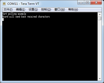

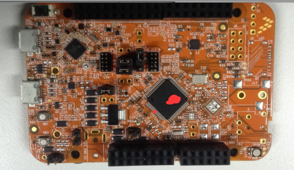

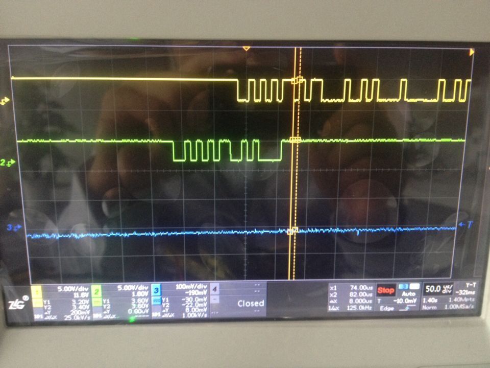

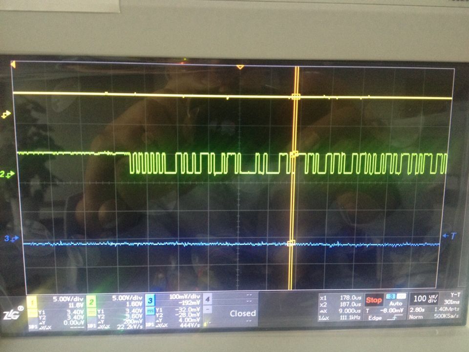

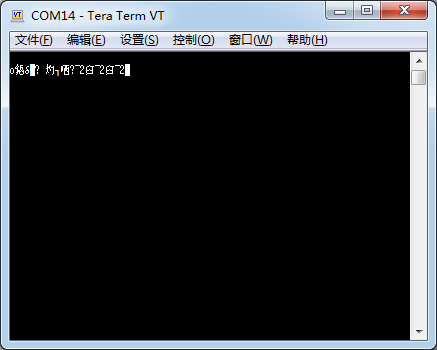

jackxu2016
Hi Kerry,
Thanks for your quick answer, but i load two sample. one is base on frdm-k22f, and another is base on mk02fn64vlf10. when core system @40MHz, frdm-k22f can send the right message to the tera term with 115200bps, but the mk02fn64vlf10 can not send the right one with 115200bps.
Due to we set the clock at 40MHz, and as caculated  FRDM-K22F can send out the right message, but MK02FN64VLF10 can't
If MK02FN64VLF10 doesn't run at 40MHz, we also can not caculate the right one
The 1st pic is from FRDM-K22F, the 2nd is from MK02FN64VLF10. both @115200bps
Need some more help, hope the 2nd one can send out right message!
Thanks in advance!
-Jack

kerryzhou
Hi Jack,
   You receive the messy code, it is normally caused by the baud rate skew.
   Normally, the baud rate deviation should smaller than 1.5%, otherwise the PC may receive the messy code.
  So, please debug the code, and check the UARTx_BDH and UARTx_BDL, then calculate the baud rate
UART baud rate = UART module clock / (16 × (SBR[12:0] + BRFD)),
 More details about the uart baud rate forum, please refer to chapter 40.4.3 Baud rate generation in the K02 reference manual.
 Please calculate your real baud rate, and compare with 115200, is the baud rate deviation larger than 1.5%?
 If yes, please reconfigure your UARTx_BDH and UARTx_BDL, to make sure the baud rate deviation should smaller than 1.5%.
Wish it helps you!
Kerry
