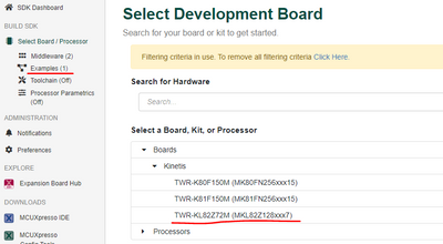

CarlosGarabito
Maybe you need to add the sample on the board first, and then, can works on CCID mode.
SDK_2_5_0_TWR-KL82Z72M\boards\twrkl82z72m\usb_examples\usb_device_ccid_smart_card\bm

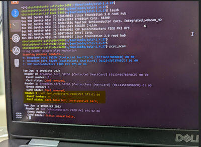

We connected the FRDM-KL82Z board to the Linux PC directly via the USB port and when we ran the lsusb command we are able to see the KL82 CCID device however we are then trying to load the pcsc scan command and the FRDM-KL82Z CCID device doesn't show up there.
On the same Linux PC we are able to mount and see the PN7462 development kit as suggested in the link above.
There is no smart card attached to the KL82Z during the entire testing. Such said, the PN7462 Development kit also did not have the Smart Card attached to it when we were testing that.

ND2
Dear @CarlosGarabito
PFA the screenshots that will showcase the fact the the KL82Z FRDM board gets mounted but doesn't show up in the pcsc_scan command.
