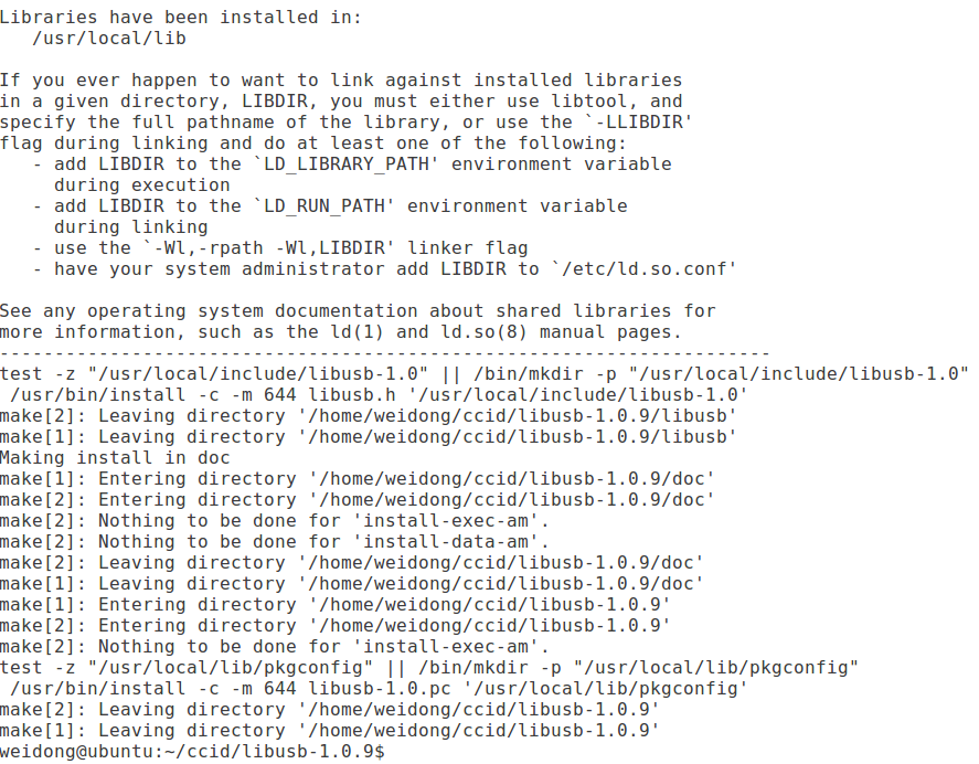

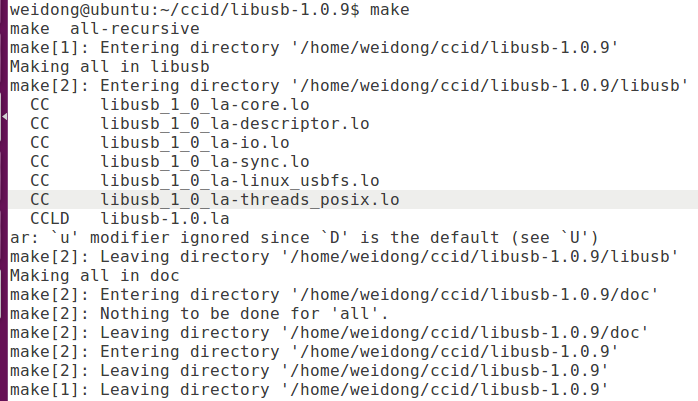

1. libus installation
(1) Download it from : libusb
File name is libusb-1.0.9.tar.bz2
(2)Decompressing it
# tar jxvf libusb-1.0.9.tar.bz2
# cd ~/ccid/libusb-1.0.9
# ./configure
# make
# sudo make install

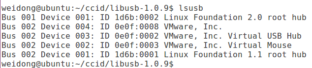

(3) test it
# lsusb

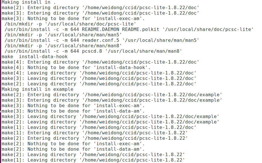

2. pcsc-lite installation
(1) Downloading pcsc-lite package: MUSCLE
Filename is : pcsc-lite-1.8.22.tar.bz2
(2) Decompressing it
# tar jxvf pcsc-lite-1.8.22.tar.bz2

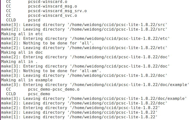

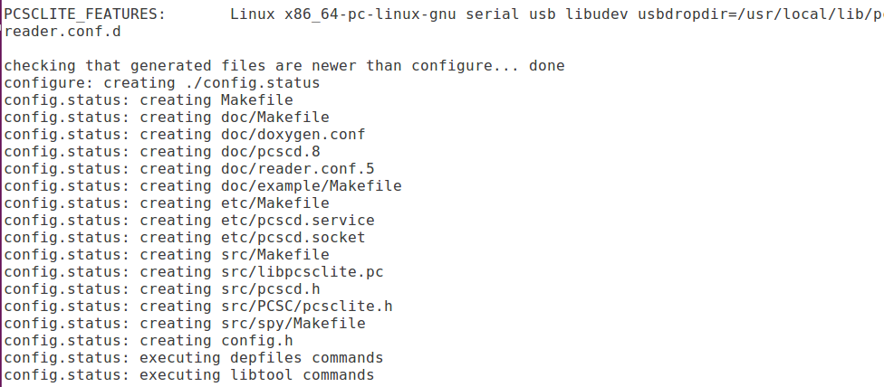

(3) compiling it
# cd pcsc-lite-1.8.22
# ./configure
# make
# sudo make install

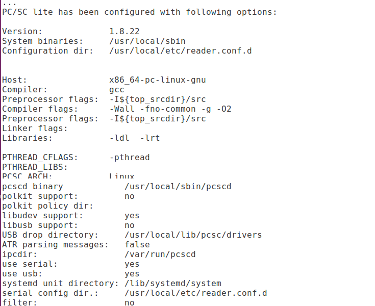

3. CCID driver installation
(1) Downloading it from : Alioth: Muscle PCSC lite: Project Filelist
file name is : ccid-1.4.27.tar.bz2
# tar jxvf ccid-1.4.27.tar.bz2

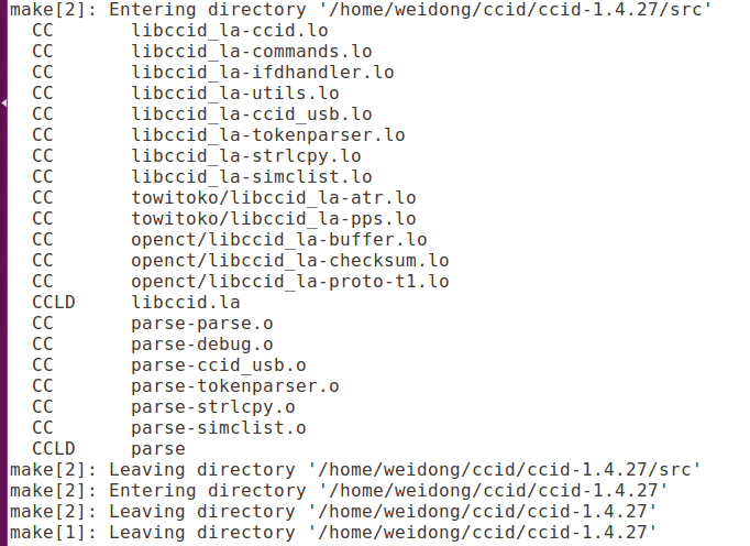

(3) Compiling it
# cd ccid-1.4.27
# ./configure
After runing configure command, information below will be displayed:

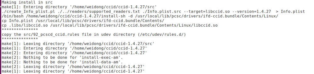

# make
# sudo make install

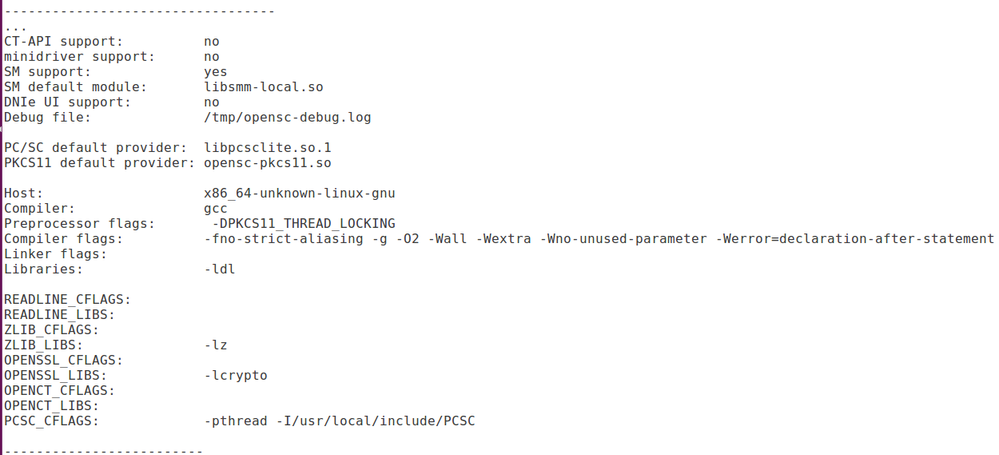

4. opensc installation
(1) Downloading it from : OpenSC - Browse /OpenSC/opensc-0.16.0 at SourceForge.net
File name is : opensc-0.16.0.tar.gz
# tar zxvf cd opensc-0.16.0.tar.gz
(3)Compiling it
# cd opensc-0.16.0
# ./configure --enable-openssl --enable-pcsc
# make
# sudo make install

5. Add Vendor ID & Product ID to info.plist
We should add Vendor ID & Product ID of NFC reader to info.plist, the file is at the path : /usr/local/lib/pcsc/drivers/ifd-ccid.bundle/Contents/. For example , PN7462's vendor ID is 0x1FC9, and product ID is 0x0117.
[Note] This requires Firmware on NFC reader board should support USB CCID, if not, customer should replace it with firmware that supports USB CCID, for the purpose, customer can refer to UM10915.pdf(http://www.nxp.com/docs/en/user-guide/UM10915.pdf ) to do it.

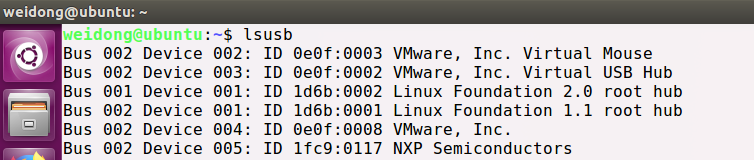

1. Run lsusb command.
weidong@ubuntu:~$ lsusb
Bus 002 Device 002: ID 0e0f:0003 VMware, Inc. Virtual Mouse
Bus 002 Device 003: ID 0e0f:0002 VMware, Inc. Virtual USB Hub
Bus 001 Device 001: ID 1d6b:0002 Linux Foundation 2.0 root hub
Bus 002 Device 001: ID 1d6b:0001 Linux Foundation 1.1 root hub
Bus 002 Device 004: ID 0e0f:0008 VMware, Inc.
Bus 002 Device 005: ID 1fc9:0117 NXP Semiconductors
weidong@ubuntu:~$

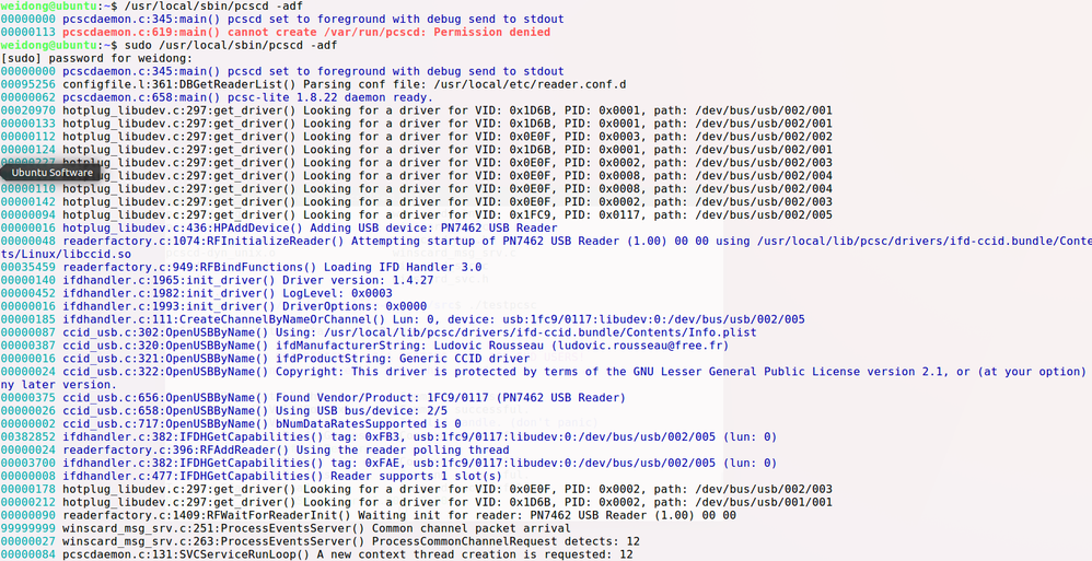

2. Open 2 terminals on Ubuntu desktop
(1) One is used to run "/usr/local/sbin/pcscd -adf"
weidong@ubuntu:~$ sudo /usr/local/sbin/pcscd -adf
[sudo] password for weidong:
00000000 pcscdaemon.c:345:main() pcscd set to foreground with debug send to stdout
00095256 configfile.l:361:DBGetReaderList() Parsing conf file: /usr/local/etc/reader.conf.d
00000062 pcscdaemon.c:658:main() pcsc-lite 1.8.22 daemon ready.
00020970 hotplug_libudev.c:297:get_driver() Looking for a driver for VID: 0x1D6B, PID: 0x0001, path: /dev/bus/usb/002/001
00000133 hotplug_libudev.c:297:get_driver() Looking for a driver for VID: 0x1D6B, PID: 0x0001, path: /dev/bus/usb/002/001
00000112 hotplug_libudev.c:297:get_driver() Looking for a driver for VID: 0x0E0F, PID: 0x0003, path: /dev/bus/usb/002/002
00000124 hotplug_libudev.c:297:get_driver() Looking for a driver for VID: 0x1D6B, PID: 0x0001, path: /dev/bus/usb/002/001
00000227 hotplug_libudev.c:297:get_driver() Looking for a driver for VID: 0x0E0F, PID: 0x0002, path: /dev/bus/usb/002/003
00000175 hotplug_libudev.c:297:get_driver() Looking for a driver for VID: 0x0E0F, PID: 0x0008, path: /dev/bus/usb/002/004
00000110 hotplug_libudev.c:297:get_driver() Looking for a driver for VID: 0x0E0F, PID: 0x0008, path: /dev/bus/usb/002/004
00000142 hotplug_libudev.c:297:get_driver() Looking for a driver for VID: 0x0E0F, PID: 0x0002, path: /dev/bus/usb/002/003
00000094 hotplug_libudev.c:297:get_driver() Looking for a driver for VID: 0x1FC9, PID: 0x0117, path: /dev/bus/usb/002/005
00000016 hotplug_libudev.c:436:HPAddDevice() Adding USB device: PN7462 USB Reader
00000048 readerfactory.c:1074:RFInitializeReader() Attempting startup of PN7462 USB Reader (1.00) 00 00 using /usr/local/lib/pcsc/drivers/ifd-ccid.bundle/Contents/Linux/libccid.so
00035459 readerfactory.c:949:RFBindFunctions() Loading IFD Handler 3.0
00000140 ifdhandler.c:1965:init_driver() Driver version: 1.4.27
00000452 ifdhandler.c:1982:init_driver() LogLevel: 0x0003
00000016 ifdhandler.c:1993:init_driver() DriverOptions: 0x0000
00000185 ifdhandler.c:111:CreateChannelByNameOrChannel() Lun: 0, device: usb:1fc9/0117:libudev:0:/dev/bus/usb/002/005
00000087 ccid_usb.c:302:OpenUSBByName() Using: /usr/local/lib/pcsc/drivers/ifd-ccid.bundle/Contents/Info.plist
00000387 ccid_usb.c:320:OpenUSBByName() ifdManufacturerString: Ludovic Rousseau ([email protected])
00000016 ccid_usb.c:321:OpenUSBByName() ifdProductString: Generic CCID driver
00000024 ccid_usb.c:322:OpenUSBByName() Copyright: This driver is protected by terms of the GNU Lesser General Public License version 2.1, or (at your option) any later version.
00000375 ccid_usb.c:656:OpenUSBByName() Found Vendor/Product: 1FC9/0117 (PN7462 USB Reader)
00000026 ccid_usb.c:658:OpenUSBByName() Using USB bus/device: 2/5
00000002 ccid_usb.c:717:OpenUSBByName() bNumDataRatesSupported is 0
00382852 ifdhandler.c:382:IFDHGetCapabilities() tag: 0xFB3, usb:1fc9/0117:libudev:0:/dev/bus/usb/002/005 (lun: 0)
00000024 readerfactory.c:396:RFAddReader() Using the reader polling thread
00003700 ifdhandler.c:382:IFDHGetCapabilities() tag: 0xFAE, usb:1fc9/0117:libudev:0:/dev/bus/usb/002/005 (lun: 0)
00000008 ifdhandler.c:477:IFDHGetCapabilities() Reader supports 1 slot(s)
00000178 hotplug_libudev.c:297:get_driver() Looking for a driver for VID: 0x0E0F, PID: 0x0002, path: /dev/bus/usb/002/003
00000212 hotplug_libudev.c:297:get_driver() Looking for a driver for VID: 0x1D6B, PID: 0x0002, path: /dev/bus/usb/001/001
00000090 readerfactory.c:1409:RFWaitForReaderInit() Waiting init for reader: PN7462 USB Reader (1.00) 00 00

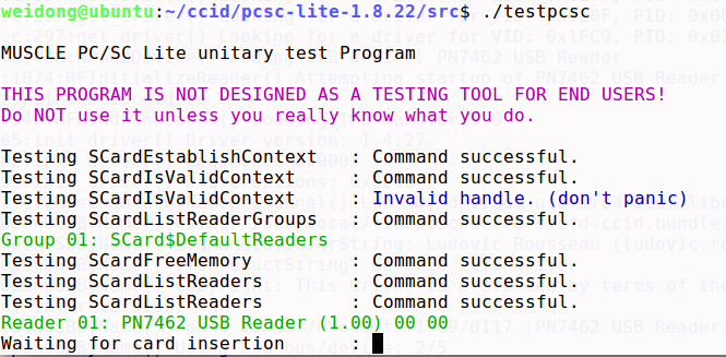

(2) The other is used to run "testpcsc " in pcsc-lite/src source code
weidong@ubuntu:~/ccid/pcsc-lite-1.8.22/src$ ./testpcsc
MUSCLE PC/SC Lite unitary test Program
THIS PROGRAM IS NOT DESIGNED AS A TESTING TOOL FOR END USERS!
Do NOT use it unless you really know what you do.
Testing SCardEstablishContext    : Command successful.
Testing SCardIsValidContext    : Command successful.
Testing SCardIsValidContext    : Invalid handle. (don't panic)
Testing SCardListReaderGroups    : Command successful.
Group 01: SCard$DefaultReaders
Testing SCardFreeMemory        : Command successful.
Testing SCardListReaders    : Command successful.
Reader 01: PN7462 USB Reader (1.00) 00 00

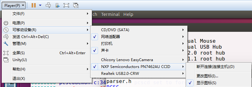

[Note] if you are using vmware player on your windows PC, don't forget to connect PN7462 board to ubuntu, see below, please!

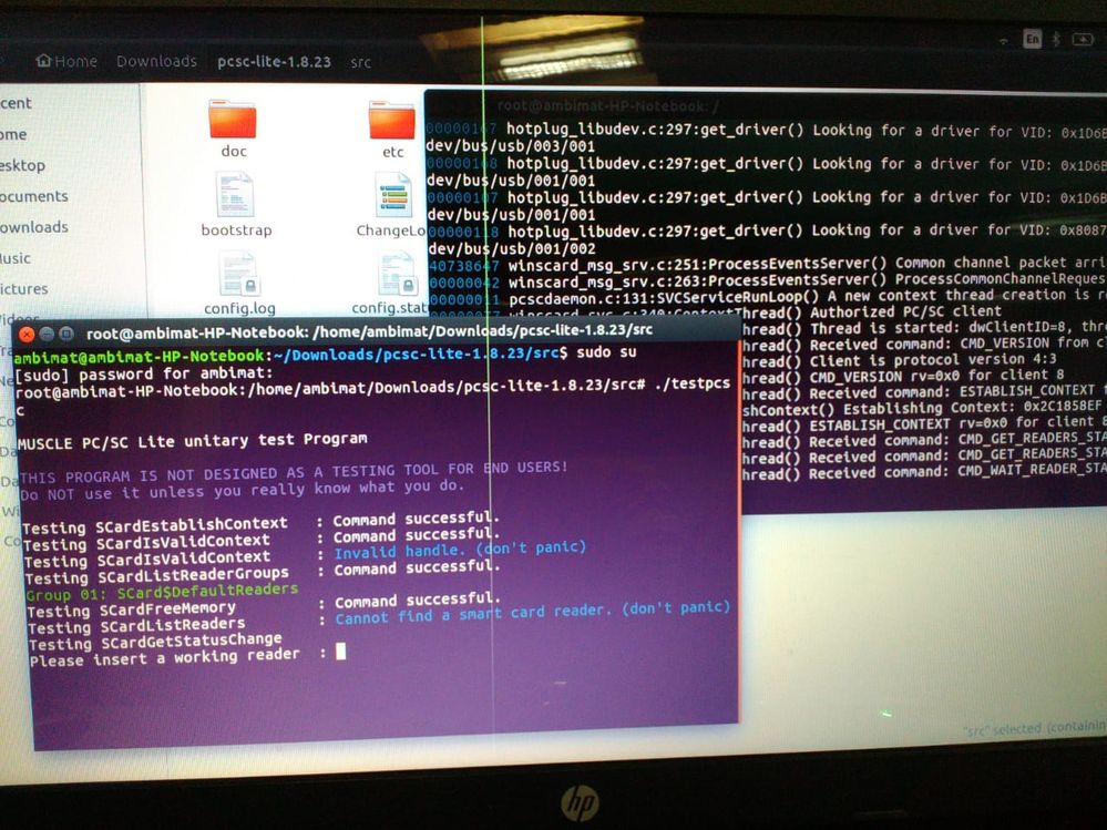

Hi Wingros,
The USB card reader has been connected. It has a SAM inserted as well as a DESFire card on the antenna.
Not sure why the SCardListReaders is saying: "Cannot find a smart card reader."
Please suggest.
Neel.
Hi, Neel,
     You shoud follow steps introduced in UM10915.pdf, compile source code with released mode , then download it to demo board.
Weidong
ND2
We know what is released mode Wingros.
Our board has the release mode firmware as suggested in the UM10915.pdf
Not sure still why the driver for the USB is not getting picked up by the OS.
Neel.
Neel Shah.
That is right! Please check 3.6 Release mode setup in UM10915 as well.
