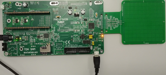

2Connecting PN7462 DEMO Board to PC USB via USB OTG Cable.
         On PENV7462B side, X3 connector should be used for USB OTG cable.

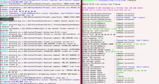

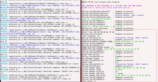

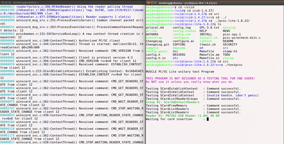

(2)The other terminal is used to run “"testpcsc " in pcsc-lite/src source code
weidong@ubuntu:~/ccid/pcsc-lite-1.8.22/src$ ./testpcsc
MUSCLE PC/SC Lite unitary test Program
THIS PROGRAM IS NOT DESIGNED AS A TESTING TOOL FOR END USERS!
Do NOT use it unless you really know what you do.
Testing SCardEstablishContext        : Command successful.
Testing SCardIsValidContext   : Command successful.
Testing SCardIsValidContext   : Invalid handle. (don't panic)
Testing SCardListReaderGroups      : Command successful.
Group 01: SCard$DefaultReaders
Testing SCardFreeMemory               : Command successful.
Testing SCardListReaders        : Command successful.
Reader 01: PN7462 USB Reader (1.00) 00 00
Waiting for card insertion        :
         2 screenshots for above 2 terminals:

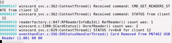

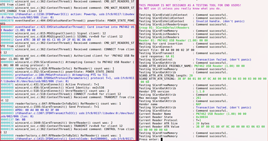

5Test cards (All cards are contactless)
(1) MIFARE Plus x 4K card
Re move it:
(2) MIFARE Nano card
         Note: testpcsc should be run again.
Remove it:
(3) MIFARE EV1 card
Remove it:

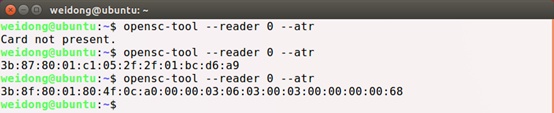

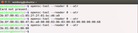

6Using Opensc-tool to Test cards
         Open a new terminal for running the command, please!
(1)No cards
(2) MIFARE Plus x 4K card (close to antenna , then run opensc-tool)
(3) MIFARE Nano card
(4) MIFARE EV1 card
