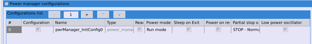

I'm trying to get a KL82Z to operate in RUN mode when necessary (when tasks need to execute), otherwise STOP mode to save power.
  • My project employs freeRTOS and Processor Expert (PE) via Kinetis Design Studio IDE
  • I'm using KSDK 1.3.0
  • I enabled tickless idle as well as the idle hook
Questions
1) Does configuring PE as follows enable both RUN and STOP mode?  Or do I need an explicit configuration for STOP as well?
2) I'm aware of the `power_manager_rtos_demo` from KSDK and have seen really low power usage in STOP mode.  In the demo, there are calls to `POWER_SYS_SetMode()` when a user enters a selection.  With tickless idle and/or Processor Expert, can I expect power mode switches to happen automatically?  Or will I need to add such calls, in `vApplicationIdleHook()` for instance?
3) More generally, what is the difference between STOP and the tickless idle state?  It seems like STOP is lower power, but tickless idle is easier to use in freeRTOS.

Answers to my original questions:
1) The power modes need to be configured in PEX and a call to `POWER_SYS_SetMode() is used.` The example that Jing provided and I revised for the KL82Z demonstrates this.
2) Tickless idle doesn't switch modes automatically.  With the NXP KL82Z SDK, it is also not supported to perform a mode switch in the tickless idle hook.  Mode switches work best from a regular task.
This blog goes over some of the details further, showing how custom PEX components can be used to switch power modes in hooks: Tutorial: Using the FRDM-KL25Z as Low Power Board | MCU on Eclipse  I didn't want to go this route since it would be a major overhaul of my project.
3) While tickless idle provides some power savings, using the power manager STOP/VLPS/VLLS gives even lower power for the KL82Z in my application.  I believe the power difference is partly that tickless idle just stops the SYSTICK clock while peripherals and other clocks keep running.  In STOP modes, even more clocks are disabled resulting in lower power.  (That's just a guess though.)

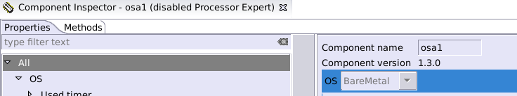

nickbedbury
Hi Jing,
With that example, I experience similar to what you described for KL82Z.  I think because the KL27 support isn't installed in KDS, Processor Expert gets disabled for me upon importing the example project:
I'm not familiar with how to convert a project to from KL27 to KL82, but working on it.
6,123 Views
nickbedbury
Turns out there was an option under Project Properties -> Processor Expert.  I needed to re-enable editing.
