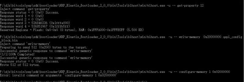

Hi Kerry Zhou,
Use your development board frdm-kl82z for debugging. According to the operations (MCU Bootloader QuadSPI User's Guide.pdf)in chapter 3 on the PDF file you provided, the prompt is as shown as the error.

Hi Duan jz,

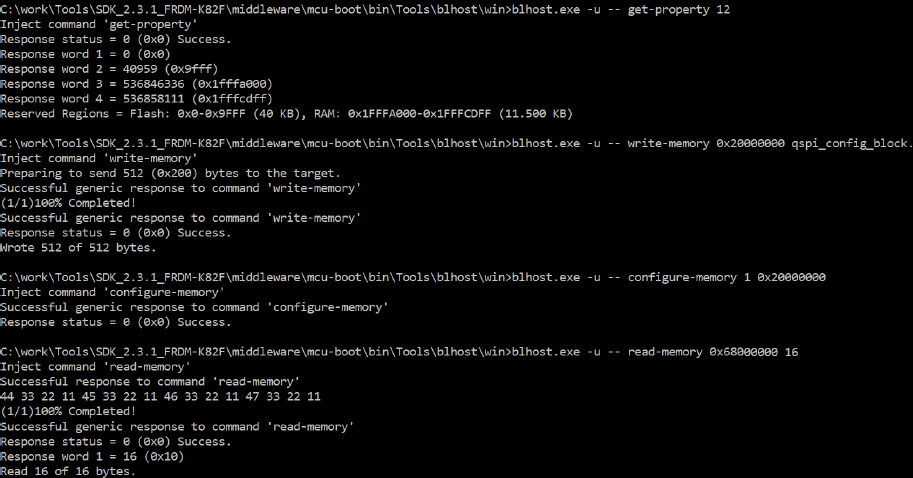

     configure-memory address is wrong, you are using 0X02000000, BUT you need to use 0X20000000
Please try it again.
Kerry
