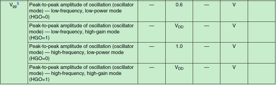

3> It is the same clock source of SCG ERCLK (clock from EXTAL0 pin). The 3V means the KL28 system OSC is 3V chip, which doesn't support 5V clock input.
