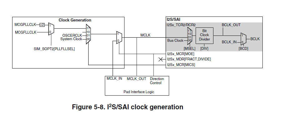

- About the configuration of SAI clock , please refer to : 5.7.10 I2S/SAI clocking of the KL26 reference manual.

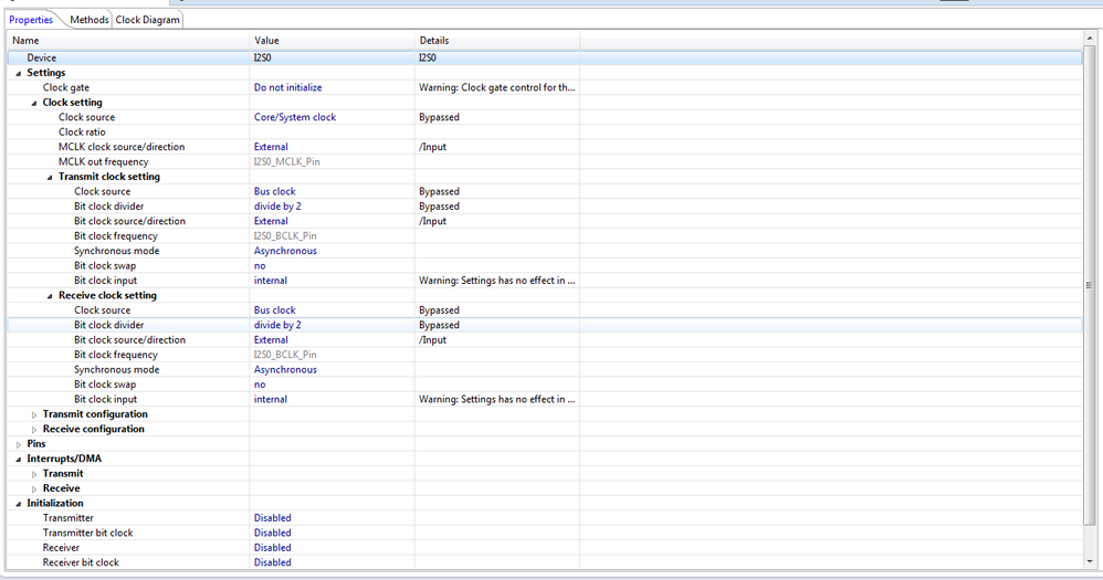

And if you use the CW or KDS IDE, you can create one project with PE, then add the component "Init_I2S", configure the CLOCK:
