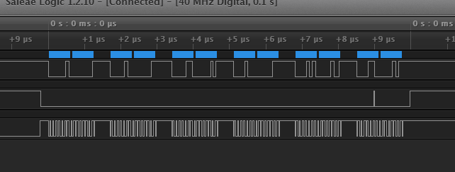

I started with the transmission parameters I've used when using SPI between two K micros.  Here is the timing for 6 - 16bit words being sent.
Notice the size of the gap between words compared to the size of the word.  I say that because the next pic is not to the same scale.
My problem is  ---- the KL17 does NOT properly acquire That set of 6 words with the inter gap shown.  I had to extend the gap to 4 times that size!!!!!!!! to get the KL17 to properly acquire.
You can see the timing of the first transmission took about 10 usec while the second timing takes over 15 usec.
I tried byte size packets instead of words and it gets worse since the inner gap has to be between bytes --- so it over 20 usec in length.

JHinkle
Senior Contributor I
Got it working.
Thanks Mark for your comments.
Joe
