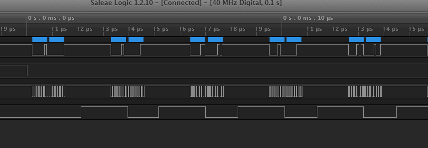

Well - I apologize for this thread.
Issue was entirely mine.
Got so use to working with faster micros, I forgot to think about the actual time required to process the IRQ on a M0+ micro.
I added a toggle pin the the SPI interrupt routine (it adds additional time).
The bottom trace is the pin toggle.  You can clearly see the latency with entering the interrupt and then the amount of time to process it.
My added delay was required to make sure the IRQ process had completed prior to another packet arriving.

I think that you missed showing the IRQ timing diagram (?)
If the IRQ is the limiting factor and overruns may take place you may also need to consider what happens when other interrupts are being processed at the same time (eg. do you use re-entrant interrupts that allow a lower priority one to be interrupted? Or do you intend to increase the gap to respect the worst case at the SPI receiver, which may be several times that of the present case in a complete system?).
Once the worst case is known, it may be better to reduce the SPI clock rate rather than add delays since it will accurately dictate the interrupt speed without the delays, which may change based on compiler optimisation or compiler version in case realised as a delay loop at the Tx.
In such cases where it looks like interrupt latency may be a potential problem it is probably also best to implement a DMA driver Rx buffer to reduce or remove such impact (or potential unreliability in case of exceptional latency that may only happen rarely). DMA + buffer should allow 12Mb/s again.
Don't forget that you look to be showing that the m0+ is spending close to 100% of its time handling the SPI IRQ when you set the present SPI equivalent speed of around 6Mb/s so there is close to no power remaining for other activities; depending on the overall requirements you may like to specify a maximum loading for this particular task so that all other tasks can achieve there work (task meaning "work" and not necessarily an OS instance).

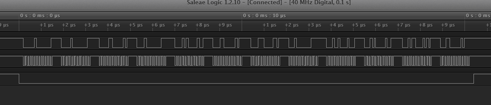

The SPI clock is running at 12 mhz (it's the upper limit for the KL17).
Using two K micros I was able to keep the timing between the packets very small.
On the KL I had to increase the time delay between the packets by 4 times or the KL would miss packets.
For the test I was polling.  Process was simply read 16 bits, write to buffer, inc buffer count, compare buffer count to max allowed, start again.
I was sending a group of 6 - 16 bit packets.  The issue was the reception of the sixth packet -- it was being missed.  I had to extend the gap size to finally acquire the last packet.
Timing for the reception of 16 bits at 12 mhz is 1.3 usec.
The KL runs really slow at 48 mhz.  The SPI on the KL does not have any kind of an overflow flag.
I had not thought of it at the time but maybe the KL is just not fast enough.  Had I considered it, I would have toggled a pin before and after the capture process and compared it to the timing of the spi packets.  Maybe my 6 packet test was the boundary condition where it takes more time to process the packet compared to packet timing and over 5 packets .. it skipped one.
I'll have to go back and re-look at this.  The issue may be my expectations of a KL working with a 12MHZ SPI ... might not be possible.

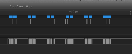

I started with the transmission parameters I've used when using SPI between two K micros.  Here is the timing for 6 - 16bit words being sent.
Notice the size of the gap between words compared to the size of the word.  I say that because the next pic is not to the same scale.
My problem is  ---- the KL17 does NOT properly acquire That set of 6 words with the inter gap shown.  I had to extend the gap to 4 times that size!!!!!!!! to get the KL17 to properly acquire.
You can see the timing of the first transmission took about 10 usec while the second timing takes over 15 usec.
I tried byte size packets instead of words and it gets worse since the inner gap has to be between bytes --- so it over 20 usec in length.
