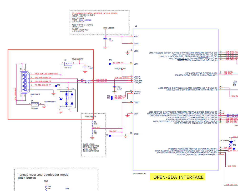

  1. I'm wondering if with this board is possible to use the USB connection for both the debugging sessions AND the puts() or printf() functions (console output) at the same time.
  2. If not, at least I would like to know if it is possible to use the USB-CDC connection for console output (no debugging) and this way I would have the physical uart at PTB1 and PTB2 free for connecting an external board.

The KL05 has a single UART and it is connected to the OpenSDA's virtual COM port on PTB1 and PTB2. The UART can however be multiplexed to PTB3 and PTB4 as alternative.
If you set PTB3 + PTB4 as standard you can connect a physical connection for FreeMaster operation.
To send debug output to the virtual COM connection (shared with the debugger) you could temporarily divert the UART output to PTB1. Whie the debug output is being sent you can avoid responding to FreeMaster requests until the UART has been switched back to the FreeMaster UART - this will introduce a short delay that shouldn't disturb the FreeMaster protocol.

I agree with Mark, it is a good workaroud for your purposes.
Regarding the USB-CDC operation I'm afraid that is not possible in the FRDM-KL05 board. The USB connection (SDA_USBSHIELD) you see on the board is connected to the K20 device that is used for the OpenSDA interface.
A USB-CDC operation needs to be configured on the target device, in this case the KL05, but the KL0x family do not support USB module, therefore is not possible to set USB operation on it.
Hope this information can help you
