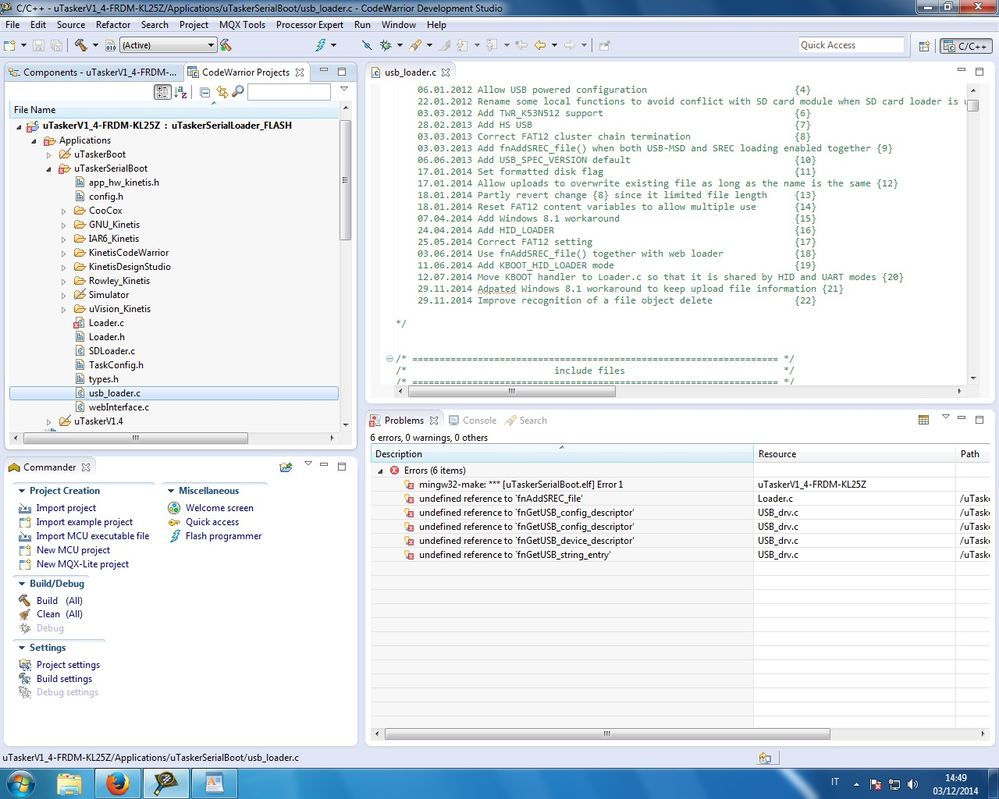

jerryfavero
Hi Mark,
with the new file usb_loader.c  there are some errors.
9,355 Views
mjbcswitzerland
Specialist V
Jerry
I think that your serial loader file is a bit too old so, to be sure, I have attached all serial loader application files newer than July 2014. These are setup for the KL25 but I think that you probably only need a newer version of the Loader.c and possibly a new header due to fnADDSREC_fil() being moved to a different location.
The undefined references to fnGetUSB_x() can not be explained by file content since these are all in the latest usb_loader.c. However I expect that they will go away once you do a clean/rebuild after adding the new files to the project.
Mark

jerryfavero
Mark
with last your files now it's ok, I tested on WIN7.
The project that I have used is uTaskerKinetisV1.4.7  « Last Edit: July 08, 2014, 03:10:45 PM by mark » KINETIS Project Code
