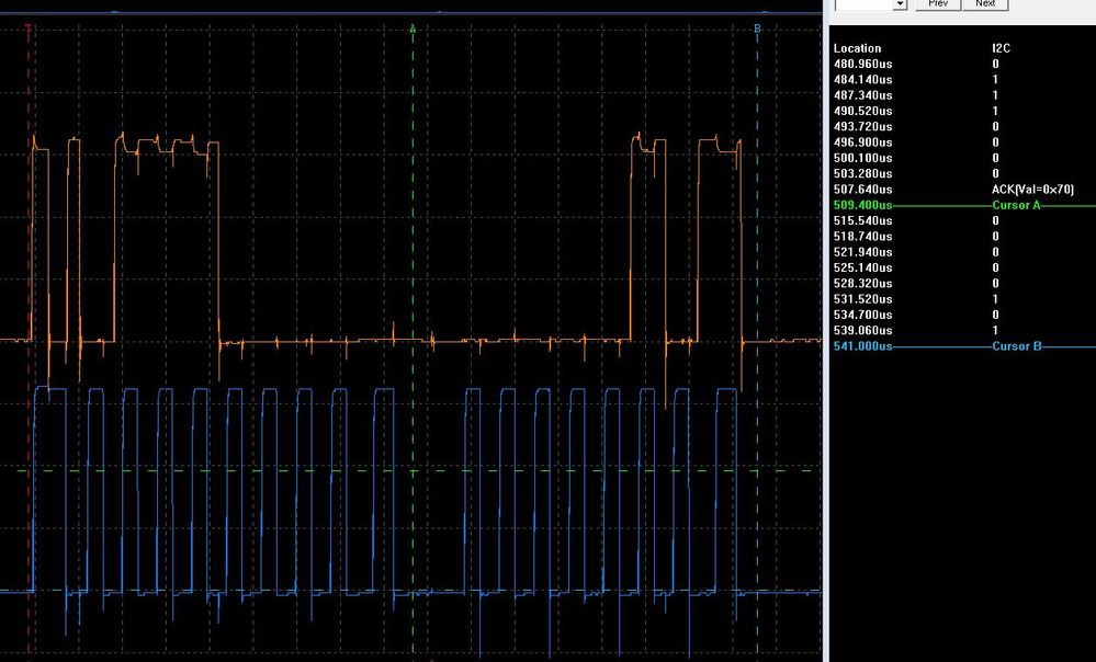

Greetings all,
I've been battling this for a while and not getting too far.
The problem is the KL05 receives the correct address from the master, ACKs it, then something very odd happens to the following byte. I have not been able to work out why.
A KL03 used to work perfectly in the KL05's place (using the KL05 now due to parts shortages).
The KL05 is running off the internal clock at 20Mhz, the bus clock div is 1 (also 20Mhz).
Attached is a image of the I2C signals. The address byte, and then the odd first data byte.

Anyone have any ideas what's going on here?

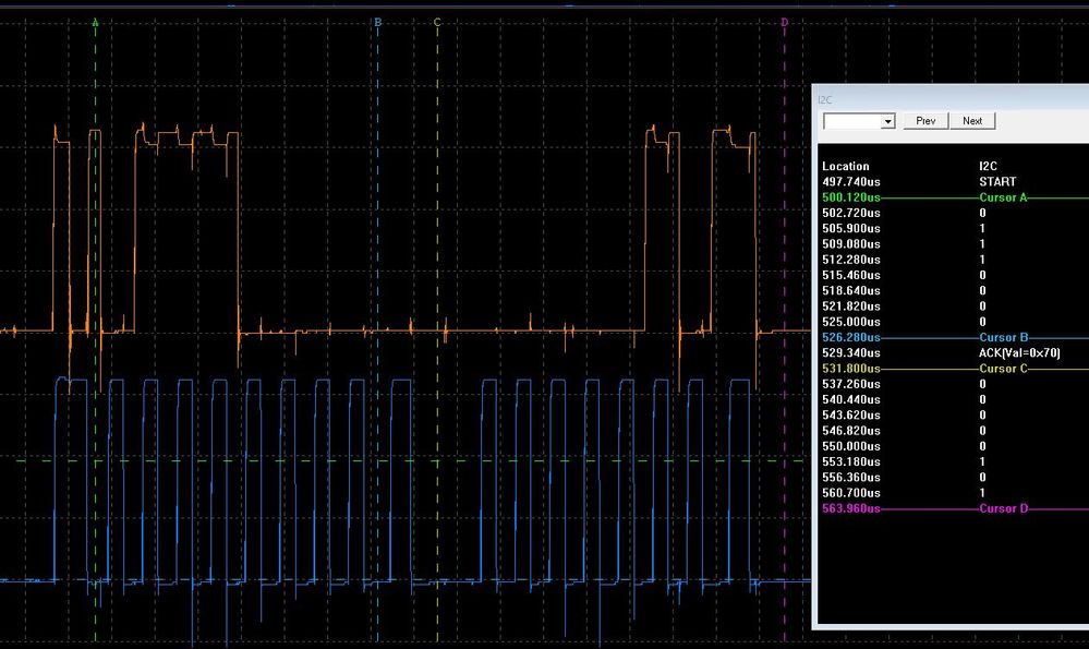

mwp_nxp
I've found something else interesting...
I have a variation of the fw that using blocking (non INT driven) handling of I2C0.
With I2C0->F=0, it does not work. It gives the same immediate result as the INT handling code.
With I2C0->F=69 (MULT=2 ICR=5), it does work for 4-5 I2C transactions before failing.
This is a capture of the blocking i2c handling code, with F=69.
