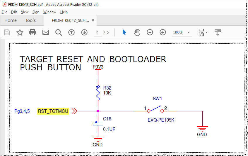

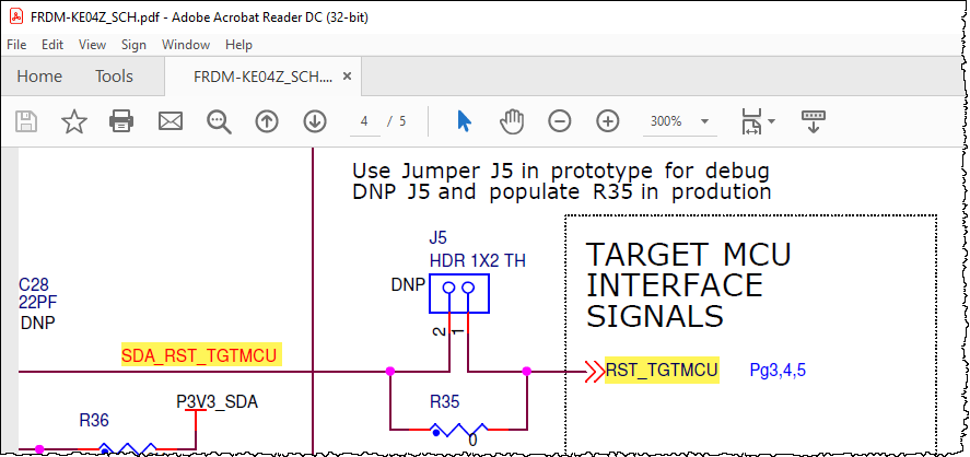

SW1 is the TARGET RESET AND BOOTLOADER PUSH BUTTON. If you didn't press it and OpenSDA is always in Bootloader-Mode, then the low voltage signal is from RESET_b pin of KE04.
TARGET RESET AND BOOTLOADER PUSH BUTTON.pngTARGET RESET AND BOOTLOADER PUSH BUTTON.pngSDA_RST_TGTMCU RST_TGTMCU.pngSDA_RST_TGTMCU RST_TGTMCU.png
If you don't have an external debugger, I'm afraid you'll need to modify the circuit.
for example:

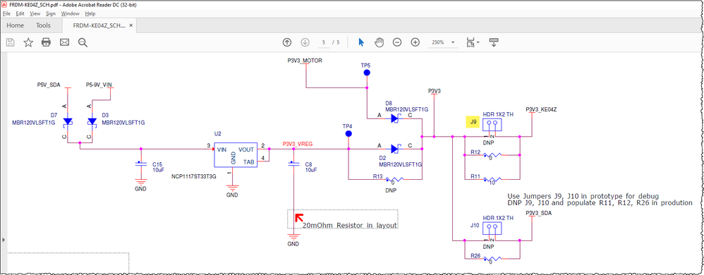

Remove R35 and use J5 to isolate the low voltage to avoid putting OpenSDA into Bootloader-Mode when powered through J6.
Or remove R11, R12, and make KE04 get power later than OpenSDA through J9.

I removed R35. Unfortunally this changed anything.
Whats confusing for me is that the pin 1 of J5 is now at 1.5V. It gets pulled down to 0V by pressing SW1. What about the 1.5V? Shouldnt this point be pulled up to 3V by the 10k resistor?
Nevertheless, the openSDA controller should not start in the bootloader now, right?

The low voltage is from RESET_b pin of KE04(the KE04 is resetting). If the voltage of pin 2 J5 is 3.3v, then you should able to make the OpenSDA exit Bootloader-Mode. refer: Recovering OpenSDA Boards with Windows 10
After recover the OpenSDA, you can connect the J5 and program KE04.
