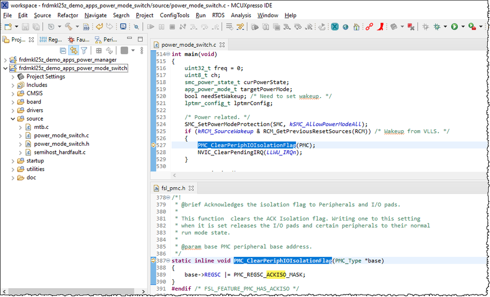

I am having some trouble getting the KL25z to wake up fully after LLS. By that i mean that I am unable to utilize the I/O pins, i.e. the PORT module, after wakeup.
I gather that i need to reactivate something, but I have been unable to find the documentation regarding this.
Below is the LLWU IRQ Handler
void LLWU_IRQHandler()
	if (LLWU->F2 & LLWU_F2_WUF14_MASK)
		// Clear Wake-up flag for pin
		LLWU->F2 |= LLWU_F2_WUF14_MASK;
		// Disable sleep on exit
		SCB->SCR &= ~SCB_SCR_SLEEPONEXIT_Msk;
	else
		if (LLWU->F3 & LLWU_F3_MWUF0_MASK)
			// write 1 to TCF to clear the LPT timer compare flag
			LPTMR0->CSR |= LPTMR_CSR_TCF_MASK;
			PTB->PTOR |= MASK(0);
	//PMC->REGSC &= ~PMC_REGSC_ACKISO_MASK;
I am using MCUXpresso with NXP SDK.
I'm kinda banging my head against the wall here.

Robin_Shen
Hi Mathias,
Please refer the frdmkl25z_demo_apps_power_mode_switch SDK example:
Robin

Bergma
Hi Robin.
I could have sworn that i already tried that. Nevertheless i worked!!!
Thanks alot
