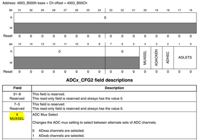

I am using the FRDM-KL05Z board with ADC.
I acomplished to use ADC in single, continuous and hardware (TPM0) trigger modes.
However, when I try to set my channel for Group B, it is not work (doesn't set the COCO flag).
As far as I know, I just need to worry about a few things to choose between Group A and B:
- The ADC0->S1[0] is for Group A and ADC0->S1[1] is for Group B, for setting the channel;
- The ADC0->R[0] is for Group A and ADC0->R[1] is for Group B, for reading the conversion value;
- Group B can only be triggered by hardware.
There is something I am missing?

Hello @matheus_pinto1,
In KL05Z Sub-Family Reference Manual. Chapter 28. Analog-to-Digital Converter (ADC). Section 28.3.3. ADC Configuration Register 2 (ADCx_CFG2) mentions the usage of bit MUXSEL, which changes the ADC mux setting to select between alternate sets of ADC channels.
[KL05 Sub-Family Reference Manual. ADCx_CFG2 field descriptions]
Could you please try to configure this bit to Adxxb to be selected?
