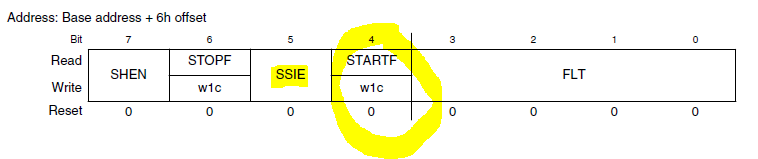

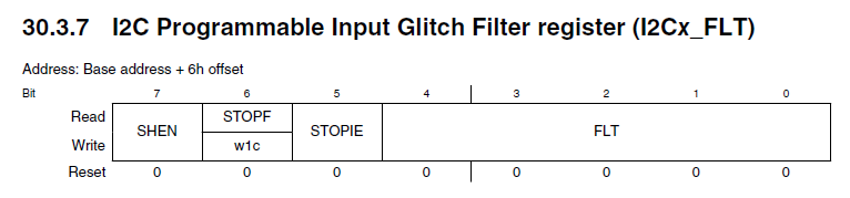

Hi Al
This is the description of I2Cx_FLT in the most up to date KL02 User's manual (Rev 3.1):
which should however be
Easy to prove - in slave mode:
1. the STARTF is set when a start condition is detected.
2 if one enables STOPIE (or should it be SSIE?) there is also an interrupt generated on the start condition.
3. It is impossible to clear the I2C interrupt flag in the status register without first writing 0x10 to the I2Cx_FLT register to set STARTF back to 0 beforehand.
Mark

Robin_Shen
Thank you for your report, and sorry for the inconveniences that this may cause you.
See the feedback from internal team:
Have talk with doc team to update it, and modification is on-going, also doc team will take some time to collect other change to generate a new version, thanks a lot!    Aug 29, 2017
Robin
