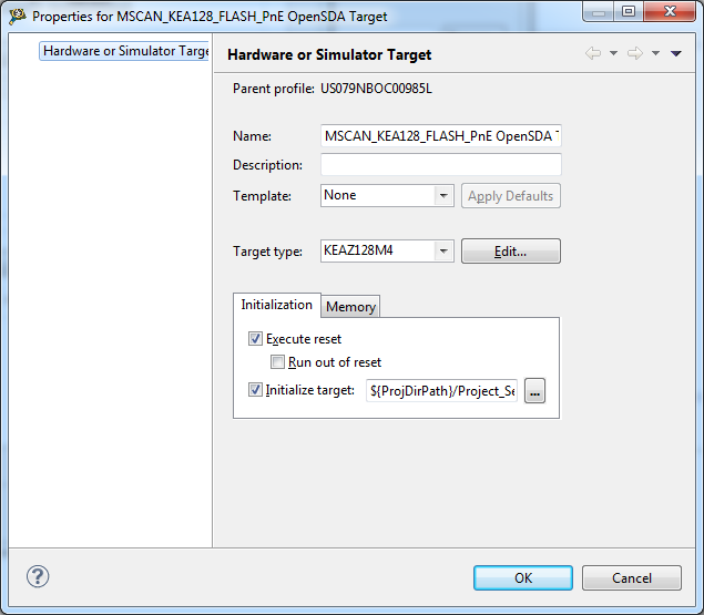

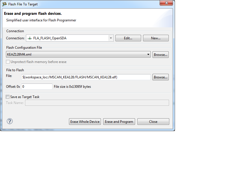

Hi,everyone:
I am using CW 10.6.
I was able to flash my KEA128 without problems, but all the sudden it won't flashing anymore, I got this error when trying:
fl::target -lc "LC for Simple Flash (2)"
fl::target -b 0x1ffff000 0x4000
fl::target -v off -l off
cmdwin::fl::device -d "FTMRE_PFlash128RAM16" -o "32kx32x1" -a 0x0 0x1ffff
cmdwin::fl::image -f "C:\\..\\TRK-KEA128_Lab1.elf" -t "Auto Detect" -re on -r 0x0 0x1ffff -oe off
cmdwin::fl::erase image
Beginning Operation ...
Auto-detection is successful.
  File is of type Elf Format.
Performing target initialization ...
Device FTMRE_PFlash128RAM16 is protected
Erasing ...........
Erase Command Succeeded.
cmdwin::fl::write
Flash Operation.  ...
Programming ....
Error:  Program Command Failed.
This happens to any project I am trying to flash into the board.
Any help is appreciated!
Alan
2,411件の閲覧回数
saya
I figured it out, the initialization and  memory tab were not configured correctly.

I changed the connection option, and it is working again, could someone explain this a bit?
2,412件の閲覧回数
saya
