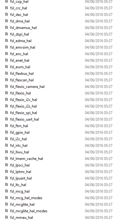

Is there a FSL for the KEA128 Kinetis MCU ? I see that there is one "Quick Start Package v5" for this MCU which contains all the driver code an necessary files which is just basic code far from the FSL found in the FRDM-K64_NFCNCI_Example project.
I am not interested to use the QSP v5 package for the KEA128, hence if there is any FSL for KEA128 or one that is compatible with the KEA128 please let me know. Thanks...

testbed
Hi Kerry,
Thanks for the info. I already have these files. I was referring to the freescale platform / hal driver package whose screenshot i have shown below. This is not for the KEA128 but for the FRDM-K64 board with K64 MCU. Only a few modules from this can be used for KEA128. So, i was wondering if this similar package was already available for KEA128.

kerryzhou
Hi testbed,
    The driver you post from the FRDM-k64 is from the KSDK2.0, but now the KSDK still doesn't contain the KEA series.
    So, you should refer to the KEA according driver:
http://www.nxp.com/assets/downloads/data/en/device-drivers/SDK-DRIVER-FRDM-KEA-S32DS.zip
  Another KEA driver is porting from the KE series by our FAE, you also can refer to it:
https://community.nxp.com/servlet/JiveServlet/download/575986-1-363361/KEA_Driver_Lib_V1.zip
Wish it helps you!
