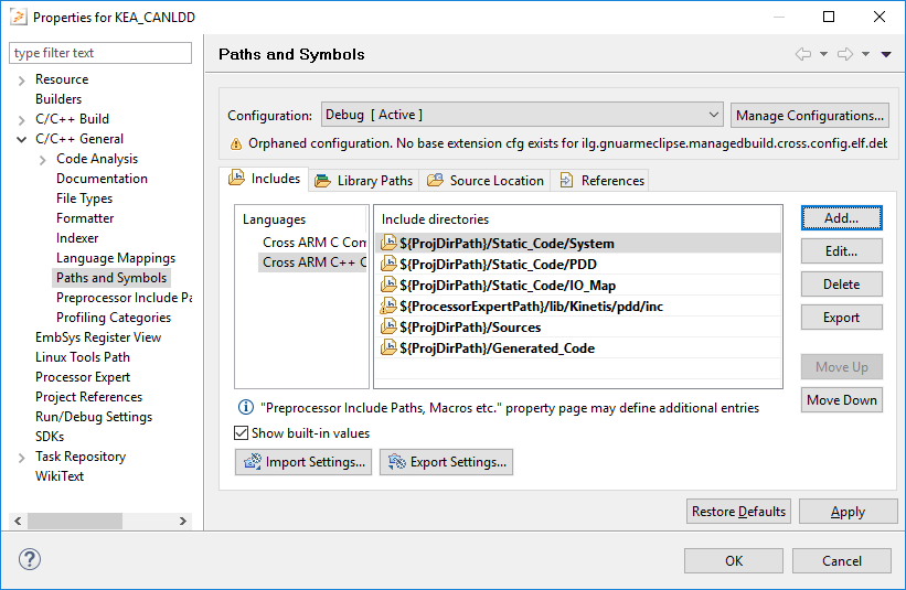

I am trying to use the workspace that you have shared, but i am not able build due to include path,
In the build path, i am getting a message that, "Orphaned configuration. No base extension cfg exists for ilg.gnuarmeclipse.managedbuild.cross.config.elf.debug.715618587", It's not allowing me to change the path as well.
I have seen this message earlier also, when i was tried to use some of the sample code, but i was end up with not getting solution to eliminate this issue,
Can you please explain me why i am getting this message.

manjunathkm
Hi Kerry,
I am not able to add or edit any of the include path
Below is the screen shot .
Let me know if i am doing something wrong

kerryzhou
Hi Manjunath K M,
  Why do you want to modify the include path?
  It should be work directly on your side.
  If you want to modify it, you can click the edit.
  This is the picture on my side:
If you are still not OK, Please check your KDS version, use the latest KDS IDE.
Kerry

manjunathkm
Thanks for your time Kerry,
I am using S32 IDE to build the project, and when i am trying to build the project, it was showing error message that path cannot be found.
Manjunath

kerryzhou
Hi Manjunath K M,
   My project is the KDS project, not the S32 IDE project, that's why you can't make it work.
   You can go to this link:
www.nxp.com/kds
 Download and install the KDS, then open my project.
Wish it helps you!
