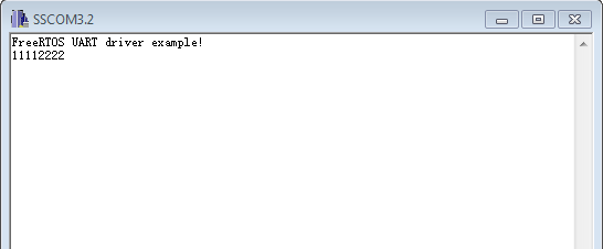

danielchen
Hi Manuel:
Sorry I lost tracking of this thread. I tested the project your attached. it works on my side. Please see the below picture.
This uart example demonstrates the possibility to use the UART driver in the RTOS. The example uses single instance of UART IP and writes string info, and then reads back chars. After every 4B received, these are sent back on UART.
