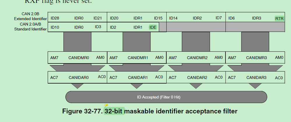

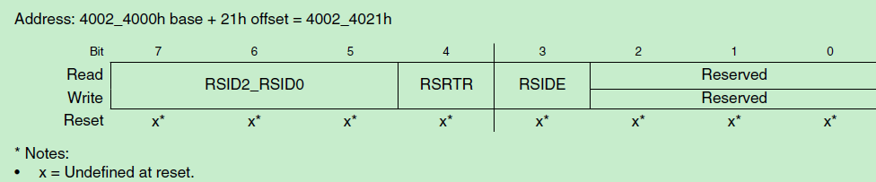

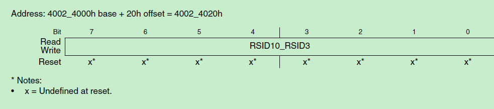

  page 638, take 32bit maskable identifier as an example:
   Standard ID is 11bit, it is from IDAR1 bit 5 to bit7, and IDAR0 bit0-bit7.
So, if you want to just receive the standard ID 0X29, you need to configure it like this:
CAN_IDAR0  : 0x29<<21

CAN_IDMR0 : 0X001FFFFF

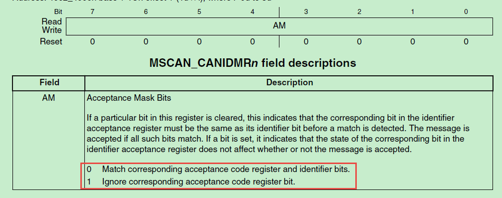

Besides, take care,
  1, is igore in filter register
0, is checking.
So, if you want to just get 0X29 standard ID, you must check every standard ID bit.
ID  :  0x29<<21 =0X05200000
FILTER  :    0X001FFFFF
Wish it helps you!
