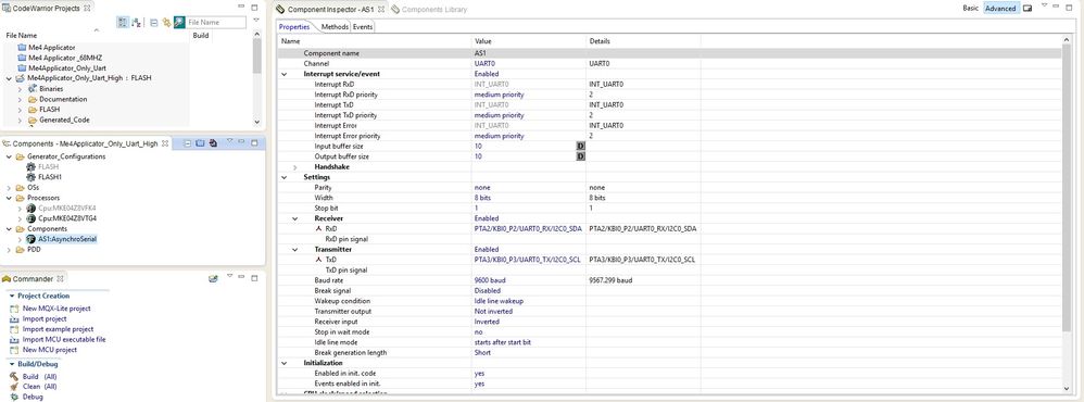

I using the MKE04Z8 device on my pcb , my problem is that I can't see anything in the line.
I configure the PTA2 as RX PTA3 as TX and used the next basic code:

I think that is something on the pin(PTA3) configuration , Any suggestions ?
BTW, The RX line works perfectly and I am attaching picture of the codewarrior window
David

The PTA2 and PTA3 are true open-drain pins, so the external pull-ups have to be used for these pins. I suggest you to use resistors of 5-10k, but it depends on real application too. Please try it and let me know the result.

Thanks for the fast answer, I connected it to 5K pull up and it works :smileyhappy:
Can I use the Internal Pull up for PTA3?
David

yes, you can used the internal pull-up, but it is quite weak - it is about 50kOhm (30 - 60k). So better is to use 5k external resistor for better noise immunity.
