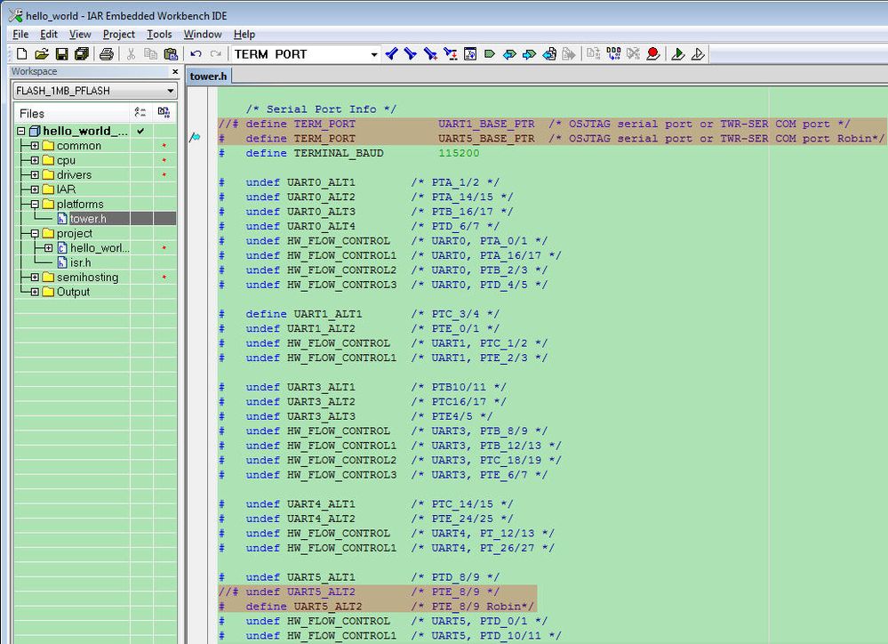

If you want use the DB9 on TWR-SER2, you need change the "TERM_PORT" defined in tower.h and define the UART5_ALT2.

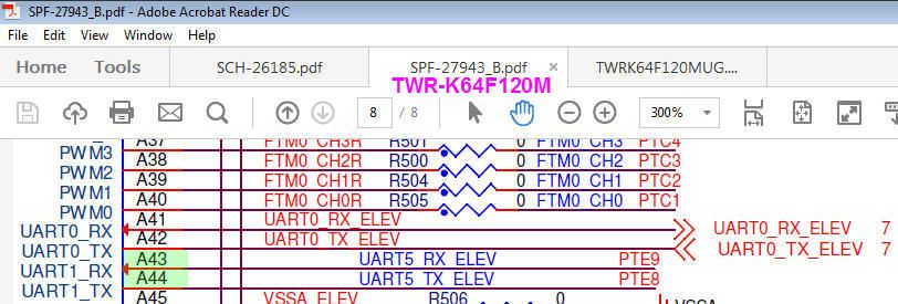

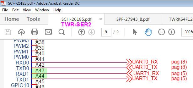

The UART1_RX and UART1_TX (TWR-SER2) are connected to PTE9 and PTE8 (TWR-K64F120) throught the A43 and A44 of TWR-ELEV.
So if you want use the DB9 connector, you should configure the  PTE9 (UART5_RX) and PTE8 (UART5_TX) as UART5 function.

After download the KINETIS_K64_SC (REV 1.2)you can find the tower.h in hello_world demo.(E:\Kinetis_K64_SC_INIT\K64F120M_IAR_Sample_Code\build\iar\hello_world)
