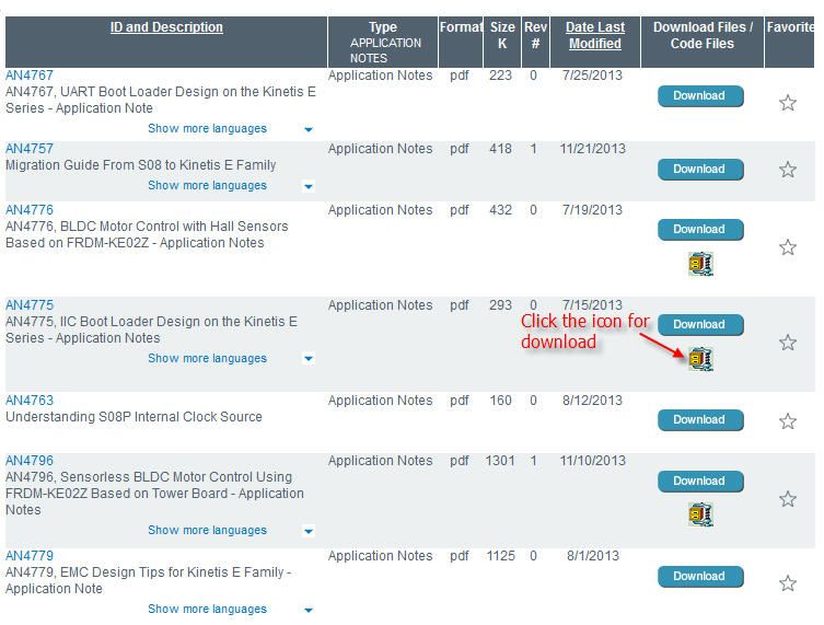

Is there a sample project somewhere for a KE02 bootloader?  I see several app notes on the Freescale site (2295, 4775, 4767), but I don't see any bootloader examples or any discussion on linking the application for download.
The protocol is easy, as is flash programming.  It's the bootloader and application linking I'd like help with.  I've done this many times before on other processors, but it seems there should be a demo project somewhere to do this.

jeremyzhou
Hi Dave,
Thank you very much for your focus on Freescale Kinetis product. I'm glad to proviede service for you.
First, I will logon this page through the link as follow. then click the icon to download related demo code.
Link: http://www.freescale.com/webapp/sps/site/prod_summary.jsp?code=KE02&fpsp=1&tab=Documentation_Tab&uc=...1.jpg

Hi Ping,
I completely missed the title of that column saying "Download Files / Code Files", sorry.  I saw just the app notes.
I have downloaded the files and will investigate.
