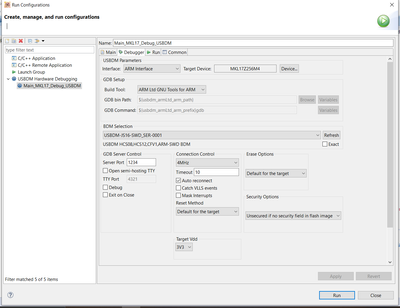

I am running KDS3.3.0. And when I press debug. There's an error:
I am using Windows 10 (x64) and debugging MKL17Z256 with USBDM. I did check that USBDM can program MCU without any error message. But what I need is to use KDS to debug my code. Can anyone tell me how to fix this problem? Thanks.

Your command line shows spaces in the command for the executable, this is probably the issue. Otherwise I recommend to consult the USBDM forum/user group?

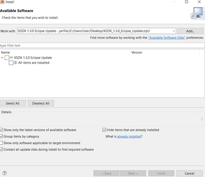

I accidentally find out that I do not have C:\Freescale\KSDK
But I already install it.
Could this be a problem? If so, how should I fix this?

no, your problem is that it cannot find the gdb for USBDM, so the path to the gdb is wrong.

Check your launch configuration: it seems to me that you don't have correctly configured the path to USBDM.

This is my first time using KDS and USBDM. I need more details to help.
Can you tell me where should I found the launch configuration? Thank you.

Menu Run > Run Configurations shows all launch configurations.

I checked the settings. And seems nothing wrong there.
I attached the screenshots in case there're some settings incorrect but I didn't find out.
JiaAn_1-1628061775501.pngJiaAn_1-1628061775501.pngJiaAn_2-1628061806440.pngJiaAn_2-1628061806440.png
