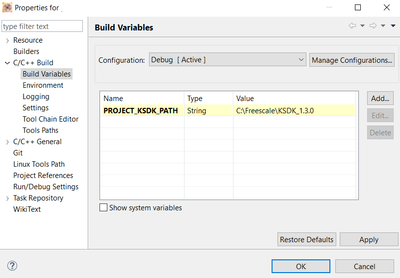

I accidentally find out that I do not have C:\Freescale\KSDK
But I already install it.
Could this be a problem? If so, how should I fix this?

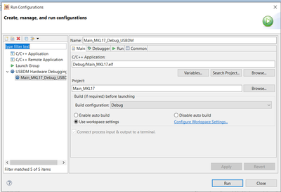

Check your launch configuration: it seems to me that you don't have correctly configured the path to USBDM.

JiaAn
This is my first time using KDS and USBDM. I need more details to help.
Can you tell me where should I found the launch configuration? Thank you.
4,308 Views
ErichStyger
Specialist I
Menu Run > Run Configurations shows all launch configurations.
4,304 Views

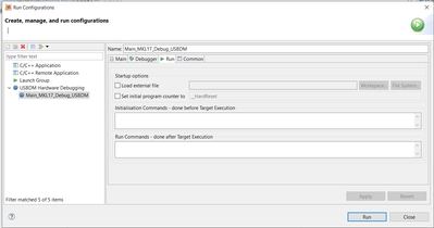

JiaAn
I checked the settings. And seems nothing wrong there.
I attached the screenshots in case there're some settings incorrect but I didn't find out.
