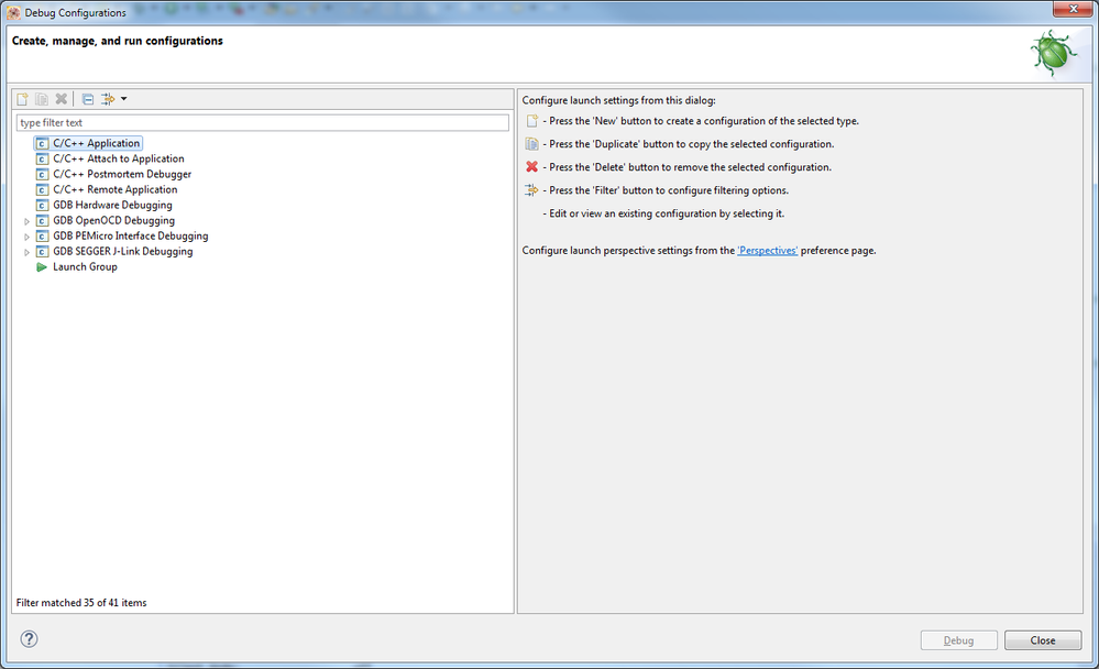

How do I use the KDS debugger, when I connect the microUSB to the FRDM K64 board?
I don't see any OpenSDA in the KDS:

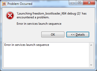

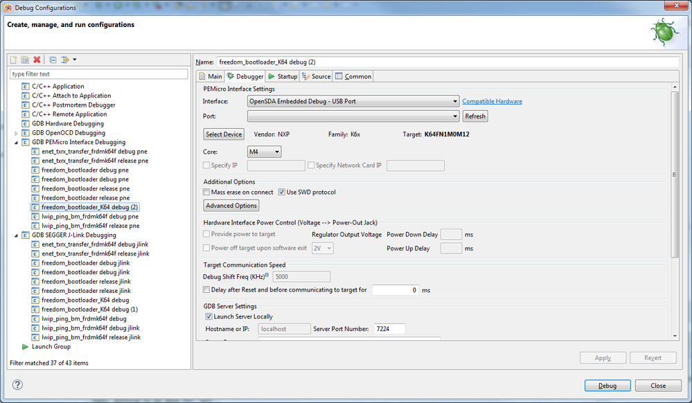

Thanks, but not working. FRDM k64 is connected via USB (to host):
And I'm getting this error message:

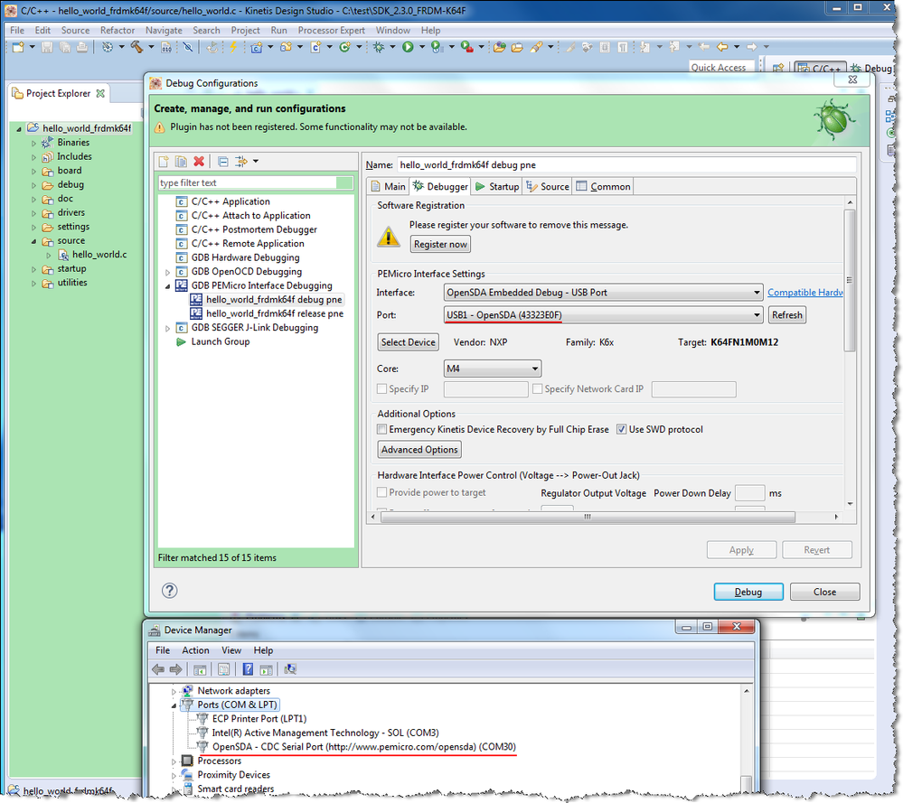

Robin_Shen
I can see the OpenSDA port in PEMicro Interface Settings and Device Manager.
Have you try to use other firmware application?
See also the Note if you are using Windows 10.
