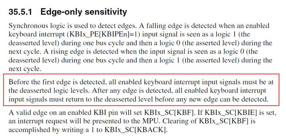

     Is it possible to use 2 KBI pins in a single KBI module? will there be any problem if i use KBI having another peripheral pin ?

   You can use 2 KBI pins in one KBI module,  but you should take care of this point in the reference manual:
    So, if when one KBI pin is in asserted state, then another KBI pin detect the edges in the same KBI module may be ignored, that's why I suggest you use two pin in different KBI module .

vignesh_vb_7
Thank you Jing,
                         I controlled 2 KBI pins in the same KBI module by flipping the polarity of edges inside the interrupt
