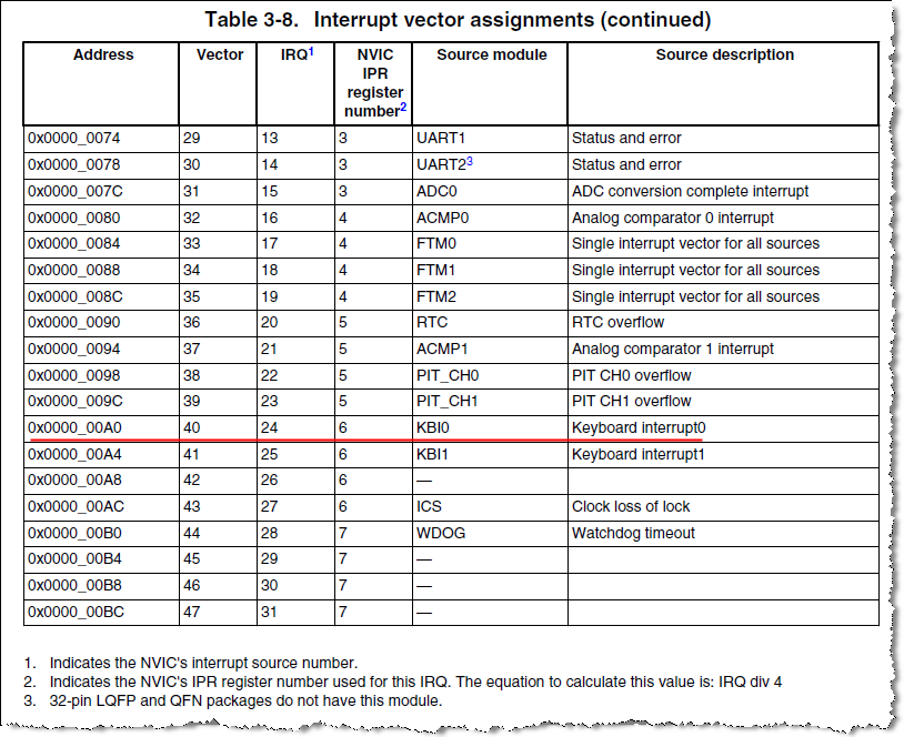

I can download the code and KBI seems to initialize ok, but the ISR is never called.
I found this post:
Making a KBI Library...
which (at the end of the reply) references NVIC_ICER and NVIC_IPER6. I see documentation on the second register - just a place to set the interrupt priority. But what is NVIC_ICER? I don't see that even mentioned in the reference manual. Is there a bit in that register that turns on the KBI interrupt?
Thanks in advance for any insight you can provide.
~LMG
2,876 Views
Robin_Shen
Here is the NVIC register summary, see NVIC_ISER and NVIC_ICER:
The Interrupt vector assignments of KBI0 in KE02 are same as KE04, you can use the codes in that post.
From your codes, rising edge is configured for this pin. Did you enable internal pull-down or put external pull-down for KBI0 pin1?
Here the "deasserted logic levels" is 0v for your configuration.Edge-only sensitivity.png
