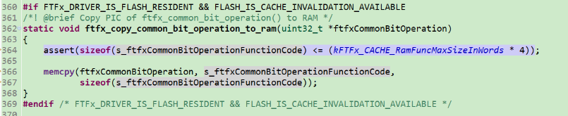

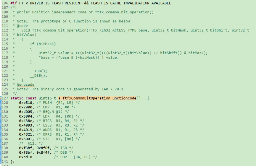

MUCXpresso SDK for K8x also has this function to execute Flash command in RAM:
<fsl_ftfx_cache.c> has below code:
Wish it helps.
Mike
