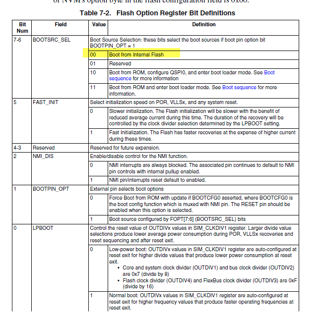

2. Please modify your FOPT, the flash address is 0x40d, you can change the code boot from the internal flash directly, instead of boot from the ROM after rest.
Then download your code again.
Check whether the problem still happens or not?

  2. OK: BOOTSRC_SEL is 0
