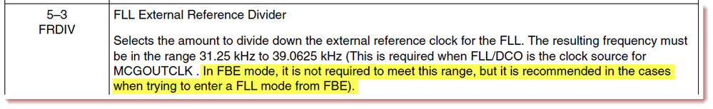

I have a problem configuring C1
Example text: "C1[FRDIV] set to 3'b100, or divide-by-512 because 8 MHz / 512 = 31.25 kHz which is in the 31.25 kHz to 39.0625 kHz range required by the FLL."
But I have 12 MHz oscillator, so 12 Mhz / 512 = 23.4kHz, 12MHz/256=46.8kHz
So I don't have any dividers to get frequency in the secified range. What value I have to set in?

Hi Alexander:
Your crystal will not allow you to match the required FLL input range. But in FBE mode the FLL is bypassed, so you can ignore the restriction. Just keep the reference as close as possible, in this case I would go with the 512 divider (ref_clk = 23.4 kHz).
Be aware that due to this situation, you will not be able to use the FLL output, so you cannot enter FEE mode.
In the reference manual you have this:
Hope this helps!

bazhaev
So, I still need 150MHz at system clock.
In FBE mode, I have to set C1[CLKS] to 10(binari).
So according to datasheet,
          10 Encoding 2 — External reference clock is selected.
It means that both core/system clock and bus clock will be max 12 MHz?
Yep, I can get 150 MHz at PLL0 for peripherals, but system/core clock is too small.
Am i right?
27,744 Views
Jorge_Gonzalez
In FBE mode your max frequency would be 12 MHz. But you can continue switching to PBE and then to PEE, so you get your 150 MHz.
