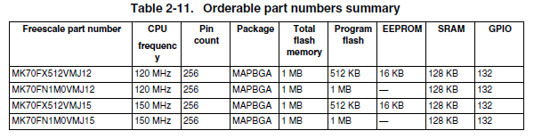

Can anyone tell me what is the size of K70 RAM. I got confused by 2 different explanation.
From the datasheet, it is said 128KB as pasted below:
Another way  is from icf file, from the file, it seems that it is 64KB.

All K70s have 128k - to be absolutely sure, always check the orderable parts in the respective user's manual:
I don't know where you got the linker script file from but it is only allocating the RAM_U (0x20000000..0x2000ffff) and not RAM_L (0x1fff0000..0x1fffffff).

jeffgu
Mark,
You completely help solved my question.
The icf file is from Freescale USB stack v4.1.1, not sure you have already updated it or not in 5.0 version. Thank you any way.
