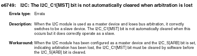

There is a published errata concerning I2C arbitration in K64 (mask 1N83J):
From a previous post I think you are using Processor Expert, right?
If so, then this might explain that behavior. Try with the workaround of clearing the MST bit before clearing th e ARB bit.

I tried switching to SLAVE RX mode before changing anything on the I2Cx_S register, but SDA still locks up on Low. Here is the piece of code at the very beginning of the IIC ISR:
byte is;
byte ic;
is = I2C1_S;
ic = I2C1_C1;
if(is & 0x10) { // ARBL
    arbl = TRUE;
    I2C1_C1 &= 0xCF; // Switch to RX SLAVE before cleaning ARBL (errata e6749)
    I2C1_S |= 0x10; // Clear ARBL
I2C1_S |= 0x02; // Clear IICIF
First, I save copies of I2C_C1 and I2C_S registers, and then I test for ARBL. If an arbitration loss has just occurred, I clear MST and TX bits on I2C_C1. Only after this, I clear the IICIF flag.

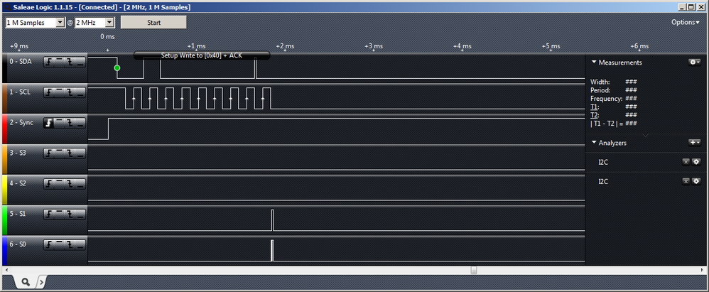

Unfortunately, it did not work. After receiving the slave ID, my boars puts SDA and SCL in Low, as it can be seen at my logic analyzer:
After receiving the whole ID, both SDA and SCL go to low. My emulator board keeps transmitting the rest of the message, but it does not show up because of the lock. Channel 2 has a sync signal that is asserted right after my board starts transmitting. The other 4 channels have the bits of a state indicator that helps me running through the flowchart. According to it, after the code above it tests if the module is in MASTER mode (if(ic & 0x20)), and the answer is still yes, even after cleaning up MST bit. Then, it checks if it has received ACK, and the answer is yes. Finally, it supposedly send the next byte.

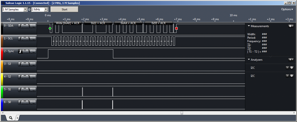

It is funny that if the ID sent by the emulator does not match my board ID, my board releases the bus, even with the same tests going through (same program flow):
Here my board releases the bus after the first data byte transfer (0x11). Notice the Sync signal that goes low after the transfer is complete or the cycle is aborted.
