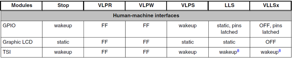

2 - Can K70 enter into low power modes while Graphical LCD keeps on displaying without any disturbance.

2.- As you can see in the following table extracted from the Reference manual, the LCDC module retains full functionality in VLPR and VLPW
