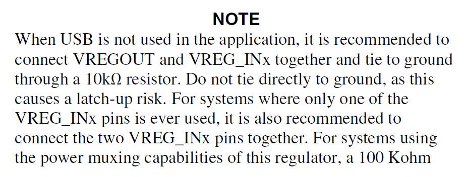

isaacavila
Hello George,
When USB Reg is not being used, it is recommended that VREG_OUT si connected to VREG_IN and both should be tied to GND by a 10 k resistor. This will prevent to increase current consumption on these pins.
Chapter 53 (USB Voltage Regulator) talks more about this.
Hope this helps!
