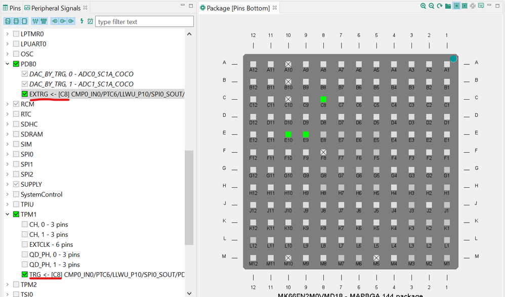

This is precisely what I mean when I mentioned that the RM is not very descriptive about these pins. In the RM, the pins are described as external triggers for the PDB module only, instead of specifying that they are external triggers for both PDB and TPM. This is why they are labeled as PDB0_EXTRG under Section 11.3.1.
However, as we saw from the Pin ConfigTools, C8 and B12 provide an external trigger for the TPM modules as well. When I set up C8 as trigger for the TPM module, the Pin tool updates the code describing it as the PDB0_EXTRG, even though I set it up for the TPM module:
    /* PORTC6 (pin C8) is configured as PDB0_EXTRG */
    PORT_SetPinMux(BOARD_INITPINS_I2S_MCLK_PORT, BOARD_INITPINS_I2S_MCLK_PIN, kPORT_MuxAlt3);
In fact, I’m able to set C8 as external trigger for both modules and they will share the same pin without conflict.
I hope this helps to clear the confusion,
Edwin.

Admittedly, the RM isn’t very descriptive about the usage of the this “external trigger”. This option should enable using an external pin as trigger for the TPM modules like you need.
With ConfigTools in MCUXpresso, we see that the TPM modules have two TRG signals routed to two pins that are described external trigger inputs for the TPMs. The usage of these pins is what the “external trigger” (0000) option is referring to.
I will consult with my colleagues as to why the RM isn’t more descriptive about these two pins. Sorry for the inconvenience this might have caused.
Edwin.

Unfortunately, the only thab I have in the 'Pins' ConfigTool is the 'Routing Details'.
Can you give me information on which pins are available as external triggers and how to configure them or a document that describes this?
Thanks!

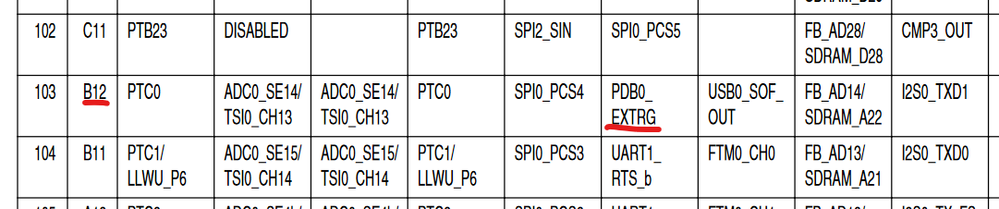

EDIT: From your picture I suspect the TRG pins for TPM1 are B12 and C8, but Section 11.3.1 'K66 Signal Multiplexing and Pin Assignments' doesn't state the external trigger function as ALT functionality for those pins, as for no other pin.
Edwin.
