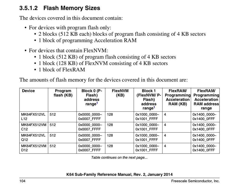

Thanks, but I think you misunderstood my question. The 'Flash memory sizes' is a section in the reference manual, and say more than physical flash memory size. For example, here is the k64 RM section:

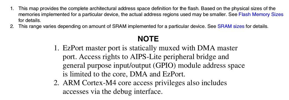

However, the k65 RM doesn't have this part, only has a link, that doesn't work:
Maybe this part is missing?

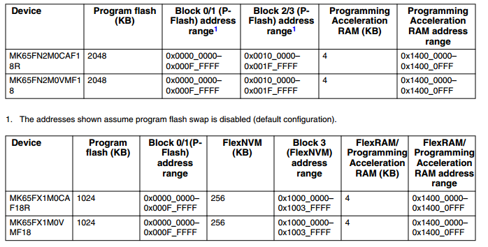

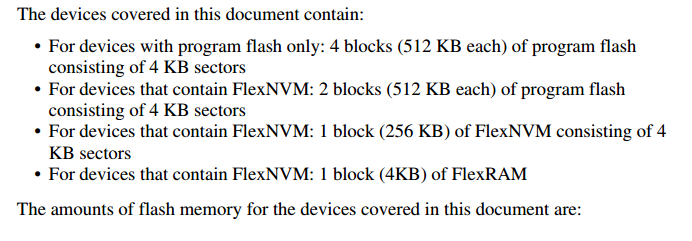

For your information, flash memory size for K65 will be something like the following.
