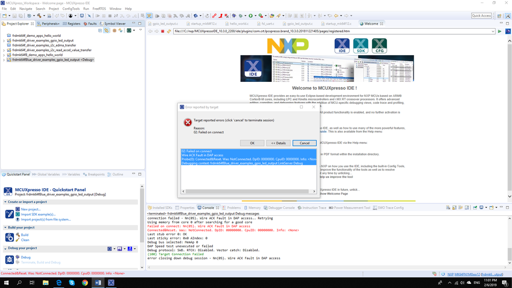

Hi, everyone. I'm trying to get started with the NXP K64F Freedom board and I just started going through the examples on the "Getting Started" page listed here.

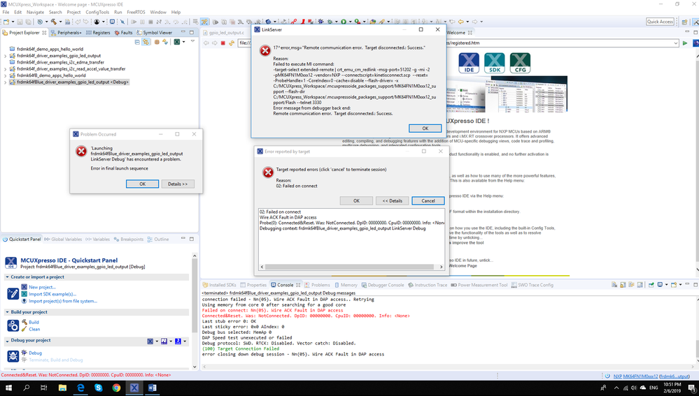

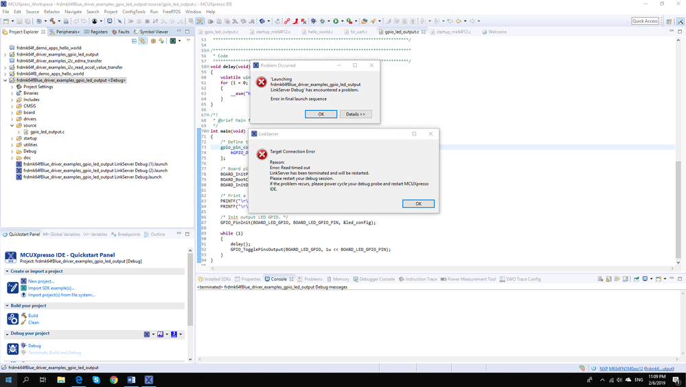

The examples compile, but the debug feature works only very rarely. It will work at first, then when I try to debug again I get one of a few errors including:
1. 17^error,msg="Remote communication error. Target Disconnected: Success."
2. Error in final launch sequence
as shown in the attached images.
I've had some luck closing MCUXpress and disconnecting the development board, then reopening MCUXpress and reconnecting the dev board, but that only works occasionally.

Hi Stephen,
I had something similar a while back with a bad USB cable. So it might be worthwile to exchange it.
The other thing you already mentioned: I recommend to use a different debug firmware which is much faster than the CMSIS-DAP one. You can choose from P&E or use the SEGGER J-Link one (Segger J-Link OpenSDA Firmware with Virtual MSD | MCU on Eclipse ). Or use an external probe if you have one at hand (Debugging the FRDM-K64F with P&E Multilink | MCU on Eclipse ), as this is anyway something to have. If costs is a concern: there is the $20 LPC-Link2 (see LPC-Link2 Debug Probe | MCU on Eclipse ) or you can use (as a  the $6 LPC8345-BRK board (not intended for that purpose, but works very well: Tutorial: Transforming the NXP LPC845-BRK into a CMSIS-DAP Debug Probe | MCU on Eclipse )).

I have the same problem, after performing the above actions twice the issue persisted.
After leaving the FRDM board unplugged for half and hour and rebooting my PC then repeating it finally worked.
It has been very frustrating, hopefully won't reoccur.
