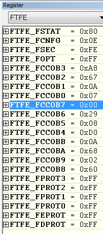

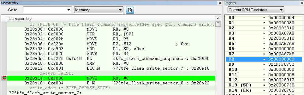

OK, I did some more debugging and this is what I see.
In ftfe_flash_write_sector I set a breakpoint if  ftfe_flash_command_sequence does not return FTFE_OK.
Looking at the disassembly window and CPU registers it appears it returned 0x4 (FTFE_ERR_ACCERR).
The FTFE registers at this point contain:
Oddly FSTAT = 0x80 which is no errors, and the only way to clear them is to write a 1 to them.

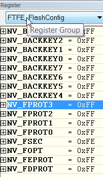

My FTFE Flash Config registers contain:
I don't see why I would get an access error!
