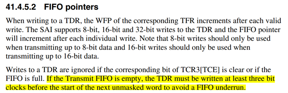

Dear,
   In my development, the I2S underrun occured, and I haven't found the way to resolve it.
   it will be appreciated with your help.
   I have two questions about this:
1. It is described in "KL26P121M48SF4RM.PDF", as highlighted below. It provides the method to resolve.
But I am confused by the words "at least three bit clocks". I can't understand it clearly, furtherly I don't know how to writte the TDR to avoid FIFO underrun.
2. I found that if a delay is added at the end of the transmit loop, the underloop will not occur. The code is as below:

2743294708
I think I have found the reason.
It maybe caused by the GPIO interrupt. The GPIO interrupt handle program takes too long time. and causes the I2S underrun.
I will try the I2S interrupt or DMA transmit. That would resolve this question.
