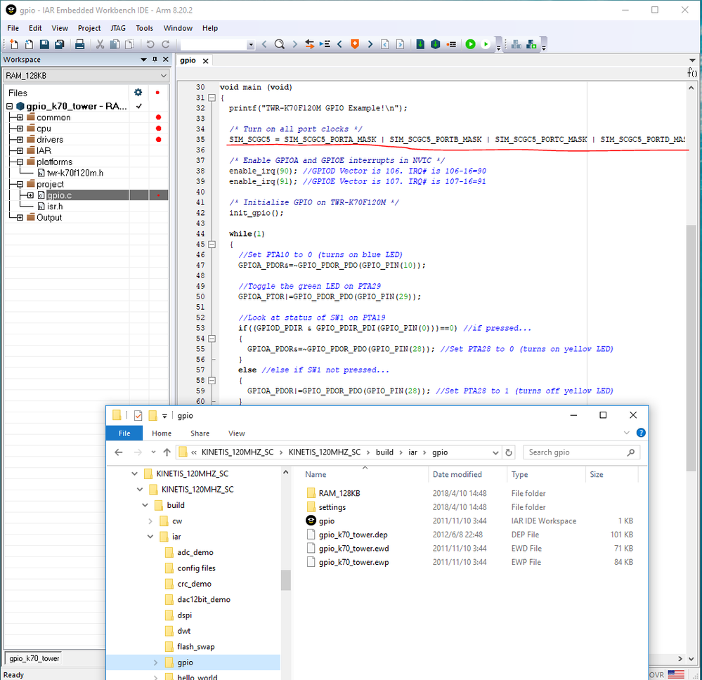

I have successfully flashed an LED blinking application on TWR K60F120M board but when I run the application the execution is unstoppable its going to some unknown memory I have flashed my code into flash address 0x00000000
Below is I have copied my code

Probably you have missed enabling clocks to the port and so it will hard faut when you try to use them.

Could you please help me with enabling the clock for PORT A for your information I am not working with either IAR or CodeWarrior IDEs. The above given is my actual code please help me with enabling clock for PORT A.

You can refer the gpio example in KINETIS_120MHZ_SC.

Set PORTA flag in SIM_SCGC5.
