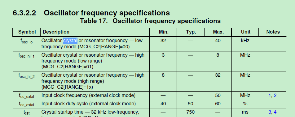

After the above points, then connect your 50Mhz to the EXTAL0 pin, and try again.
Please note, your should use the 50Mhz as the external reference clock, not the crystal. The OSC just can support up to 32Mhz.
