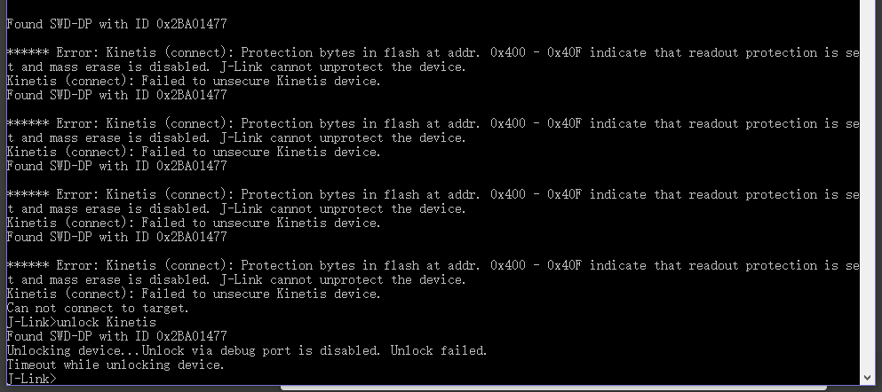

kerryzhou
Hi qiuhua,
    Please change your FRDM-K66 board 's debugger firmware to JLINK, and also install the jlink driver.
    Then use the JLINK commander window, and input: unlock kinetis
     If you still can't erased, your chip is really secured to the highest level, it can't be secured again.
Please try it at first.
Kerry

leoq
First of all , Thank you for your answers.
I don't know the level of secured,and if use the Jlink commander input: unlock kinetis,then display Timeout:QQ截图20170121162513.png

kerryzhou
Hi qiuhua li,
  Please in theJLINK commander, input:
mem 0x400, 0x10
  Then give me the output data.
Kerry
2,573 Views

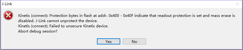

kerryzhou
Hi Qiuhua li,
     Your chip flash is protected, and you even disabled the mass erase, I don't know whether you also secure the chip.
    If you secure the chip, also disable the mass erase bit, and your chip is secured, then your chip is in the highest secured level III. it will can't be unsecured any more.
