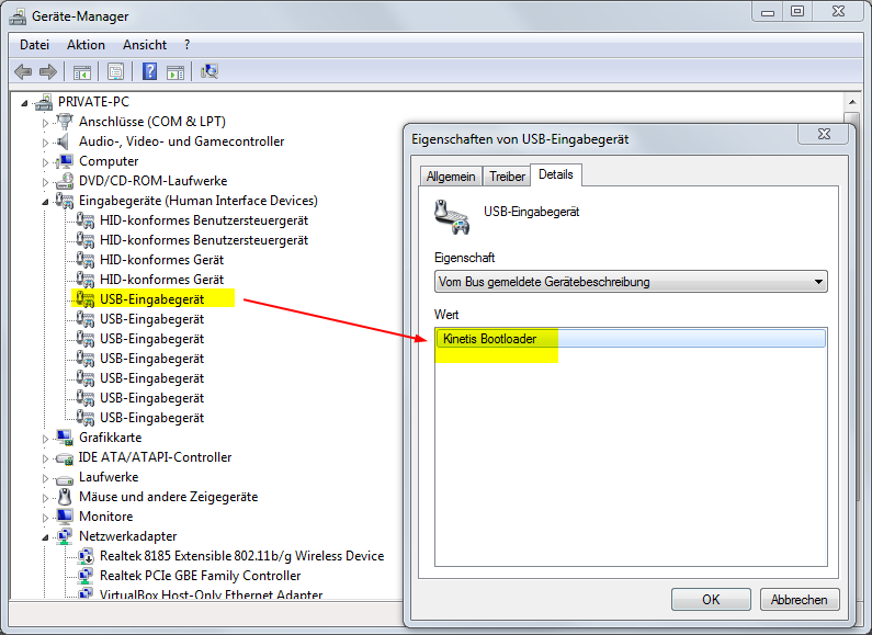

Hi! Allow me the simple question. I connected a MKL27Z circuit via USB to my Win7, and the device manager
seems to have recognized it. How may I upload my firmware?mmc_2017-01-13_20-42-01.png

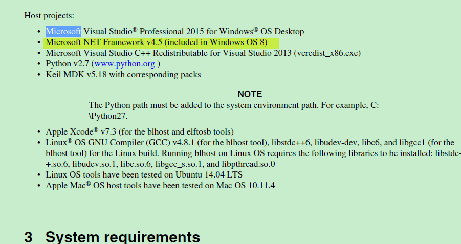

Hi Kerry! Thanks, I finally got the firmware on, after a long journey. At first KinetisUpdater.exe
(E:\Program Files\FSL_Kinetis_Bootloader_1_2_0\bin\win\KinetisUpdater\KinetisUpdater.exe)
crashed. I could solve it by updating my Microsoft .NET 4.0 to .NET 4.5.

HI kicad1978,
    This request already wrote in the kinetis bootloader v2.0.0 release notes.pdf:
    So, next time, please read the release note, must keep the tool meet the release note demand.

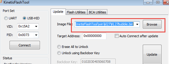

2. open KinetisFlashTool in KBOOT2.0:NXP_Kinetis_Bootloader_2_0_0\bin\Tools\KinetisFlashTool\win
   Choose USB-HID, you will find the VID and PID number:
3. Select the KL27 .bin file  in the browse.
I have attached a bubble.bin file for your testing.

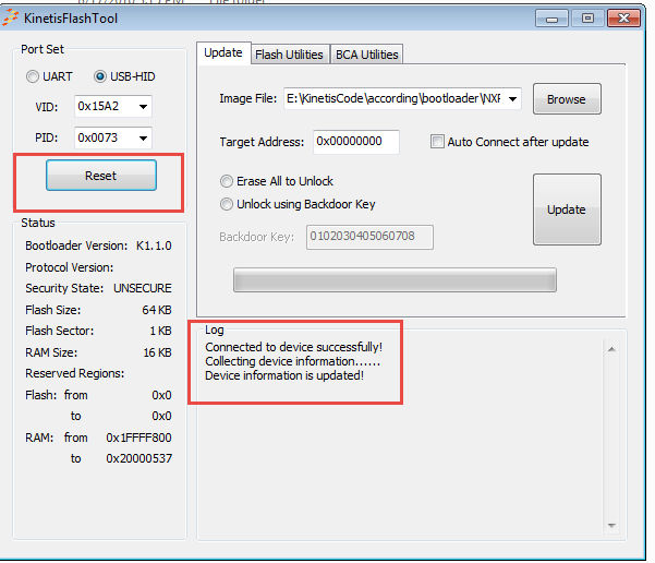

4. Press the onboard reset button, and then quickly click connect button in the KinetisFlashTool
You will find the log is connected.

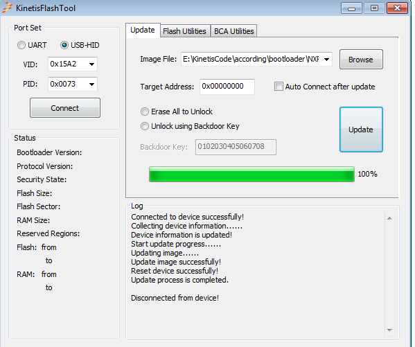

5. click update button, to program the application code with USB interface.
   The following picture shows the application code is successfully downloaded to the board, you can check the board function, when you move the board, the on board led is blinking.
It means the USB ROM bootloader works.
