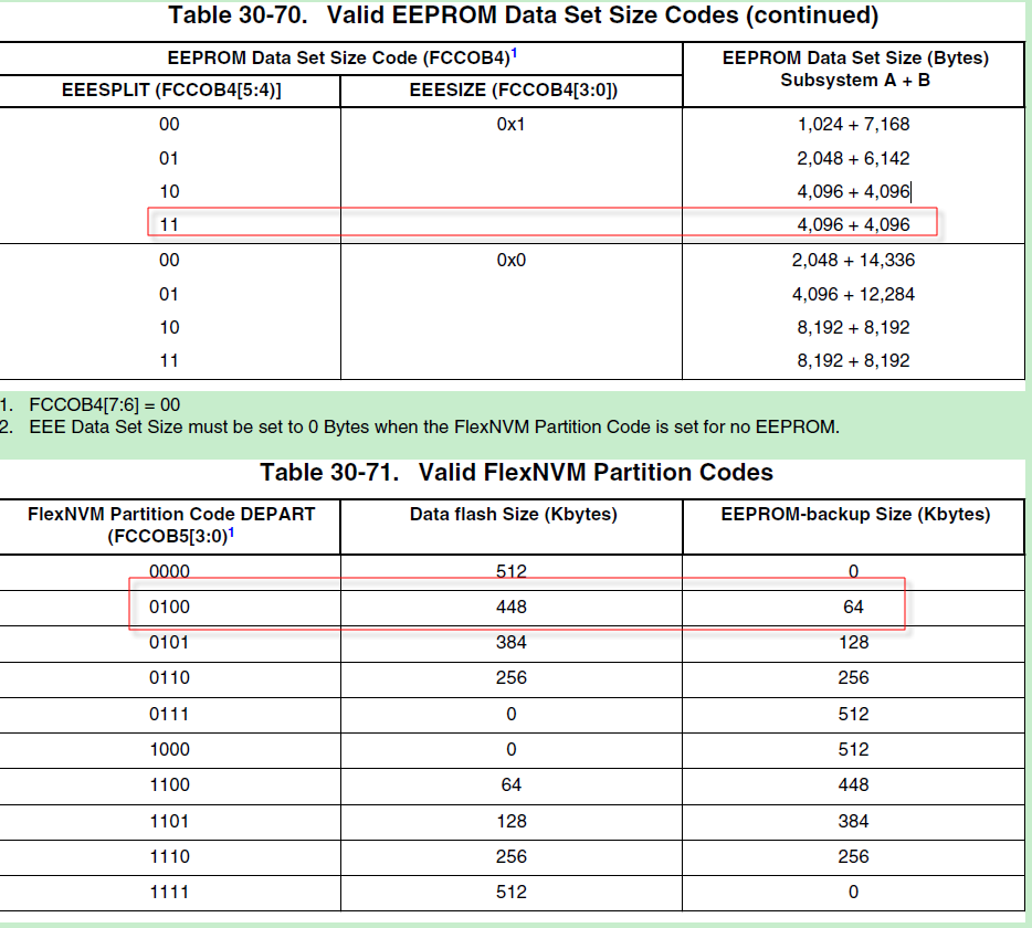

kerryzhou
Hi Kwon,
      Thank you for your interest in our kinetis products!
      If you want to set partition that data 448K, eeprom 8K.
    You should choose EEPROM_8K_8K = 0x31, DFLASH_SIZE_448= 0x04.
    I have a project based on CW, you can refer to it, please find in the attachment.
    You should do a mass erase at first, then run my code from the RAM.
    But you should keep in mind, your EEPROM backup size is too much small, our reference manual says: The EEPROM backup size must be at least 16 times the EEPROM partition size in FlexRAM.
    So, you need to enlarge your eeprom backup size.
Wish my answer will help you!
If you still have quesiton, please let me know!
Jingjing

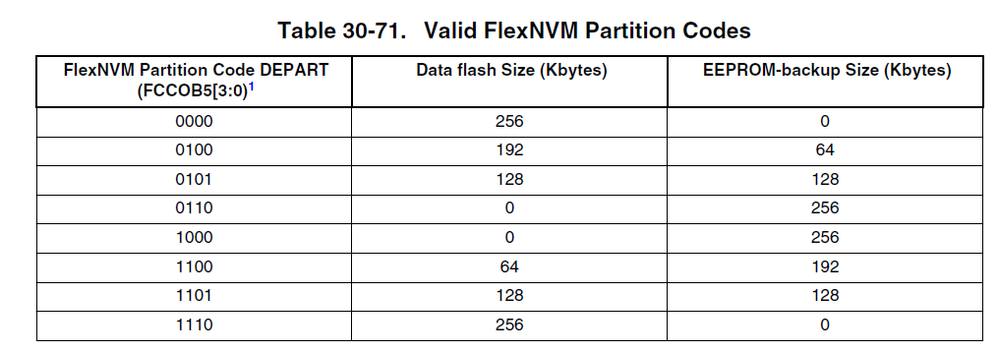

dmitriyc
Hello Jingjing,
What reference manual are you using? Is there an update in the works that isn't on the public website yet? I have been looking at
Document Number: K60P144M150SF3RM
Rev. 3, November 2014
for info about MK60FX512VLQ15.
The table it shows there is different and therefore confusing. I looked on the website to get the newest version, but I still end up getting the same file when I download it. What you posted makes more sense.

kerryzhou
Hi dmitryic,
     You should refer to K60P144M150SF3RM.pdf, Rev. 3, November 2014, this is the newest.
    The picture which I post is from Rev. 2, Dec 2011, that is the old document(at that time, the rev3 is not launched), it have bugs, so now, you should refer to rev3.
Jingjing

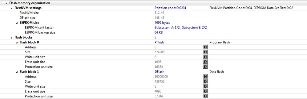

dmitriyc
Hi Jingjing,

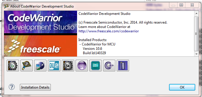

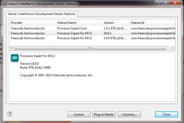

That chip has 512K of FlexNVM. The newer document only describes allocating between 0 and 256K. Processor Expert allocates 512K as described in the older document, see screenshot. Which is why I say that what you posted from the older document seems to make more sense. If i'm missing something and the newer document is correct, please explain. If the allocation is per-block, then that raises a lot of other questions.
I have a recent version of Codewarrior, here's the info for reference in case that matters.

kerryzhou
Hi dmitriyc,
     Sorry for my misleading, the newest reference manual (rev3) is not correct in the Valid FlexNVM Partition Codes table.
     The rev2 is correct, so please refer to rev2, I already attached it.
     About this document error, our document department will fix it.
    Sorry for the inconvenience bring you.
Jingjing
